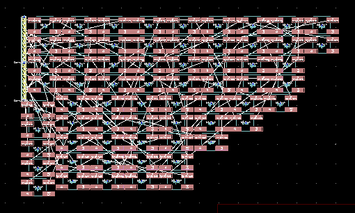

I don't find this Kicad very intuitive but I have made some progress and created foot prints in a net list pulled in to the PCB as a right mess as attached. :o :D
Derek_Stewart wrote:The Footprint is missing from the zip file.
I can't understand that since it is the file in my custom.pretty folder that is pulled in to PCB as in the picture so the foot print must be there.
Derek_Stewart wrote:The other slight issue is the connection to the QL Board, which needs a ribbon cable or cable with a thin PCB to suit the keyboard connectors without causing damage.
Remember I see this as a noddy keyboard but I envisaged either gold plated long thin pins on sockets that I have somewhere and could solder wires to or perhaps the 0.1" pitch ribbon like used on the microdrives. Another idea is solder thick wires to Veroboard and bash them with a hammer to flatten them like a ribbon so they can be poked in the QL board socket.

The files and library management is a mystery to me like the file system of Linux and just like Linux there are many ways to do the same thing. :roll: To get to where I am now I had to go back to the schematic thrice in order to give each of the switches the footprint and library location. Then it lost all the references SW that might be a bug. After that the generated netlist still had 5 errors of missing footprints. That was definitely a bug where it had lost them and I had to enter them again for just five switches. I still might have to edit the schematic because on attaching the connector footprints it deleted the symbols and when I entered them again I might have put the pin 1 at the wrong end from fatigue so that needs checking. :( Still I am learning how to use Kicad all be it the hard way and I will be able to do my main project, the pathogen disruptor MK3, more easily. :) It should be straight forward to position the components from the above state so it is just the output file generation for manufacture that might give problems. We shall see. :|

The switch footprint is okay, once imported into PCB-NEW. I importrd it into a project specific library.
There does not seem to be a Schematic symbol file.
Do you know the manufacturer of the switch?

Derek_Stewart wrote:There does not seem to be a Schematic symbol file.
The switch symbol is in the standard library as Switch:SW_Push. Do you want me to send you my schematic?
Derek_Stewart wrote:Do you know the manufacturer of the switch?
Nope. But it is probably a Chinese copy of an Omron B3FS-4.
