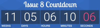

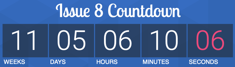

Anyway, I'm going to get back to the video system of Issue 8 now. It won't gain anything from the OSSC at all, as the timing will be fixed and output video will have PAL-legal timing.
