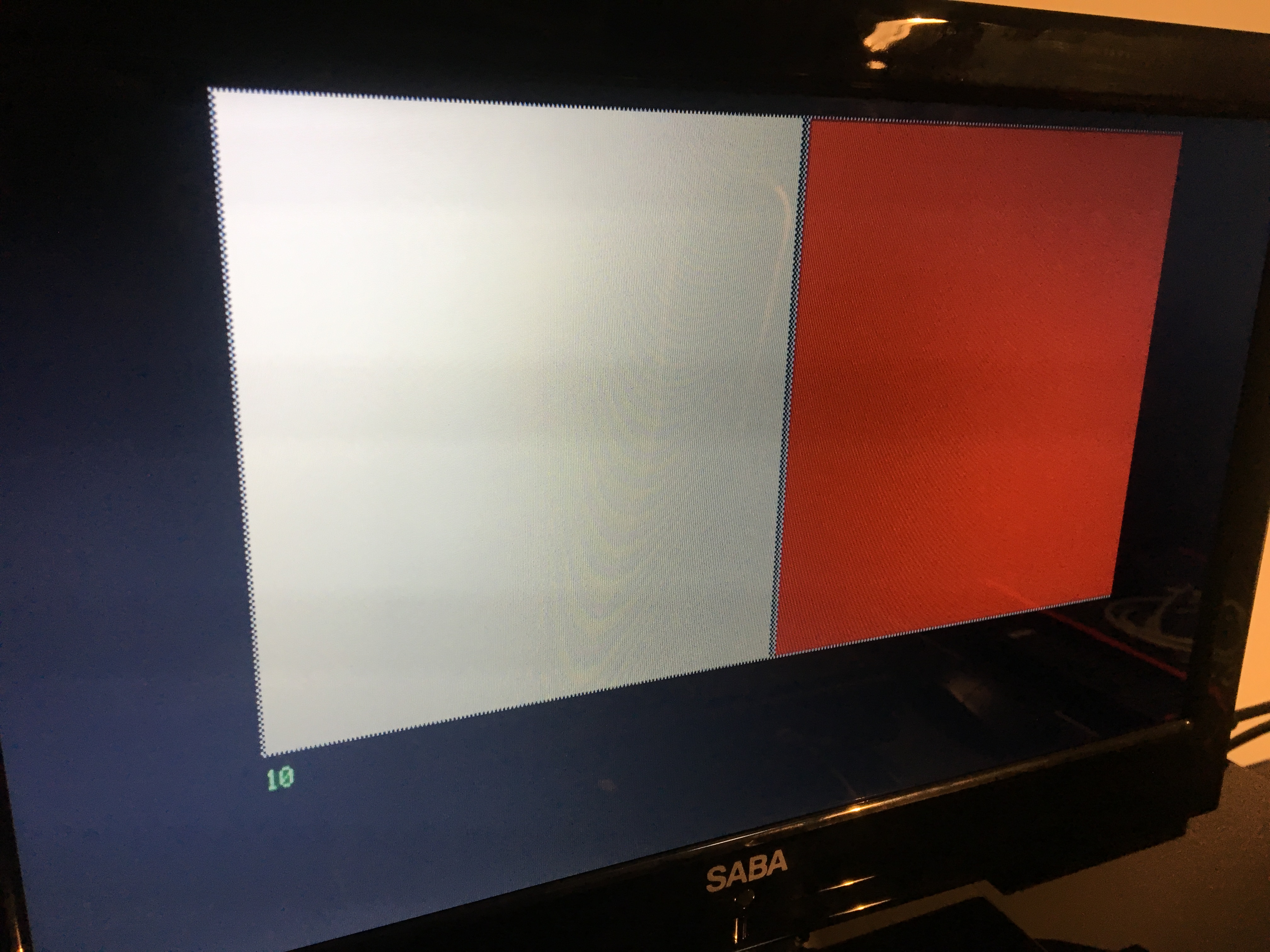

I'm using an RGB to SCART video.
If I launch the QUILL application I see the pefect picture,
but before executing QUILL I'm not able to see three characters on the left
of the monitor/tv.
Is it normal?
Thanks!
M.

It's normal. QL uses overscan, so all TVs are loosing a few chars left and right. (On my Hitachi 24HB4C05 TV I only loose 7 pixels left and right - and so far this is the best TV I have seen for using with a QL )
That is why in monitor mode the QL has 85 columns, while in TV mode only 74.
Quill is just not using the full width of the monitor and that is why you can see the whole pic.

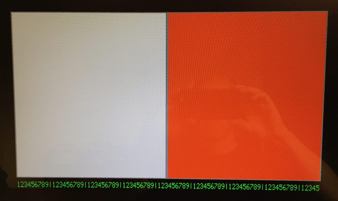

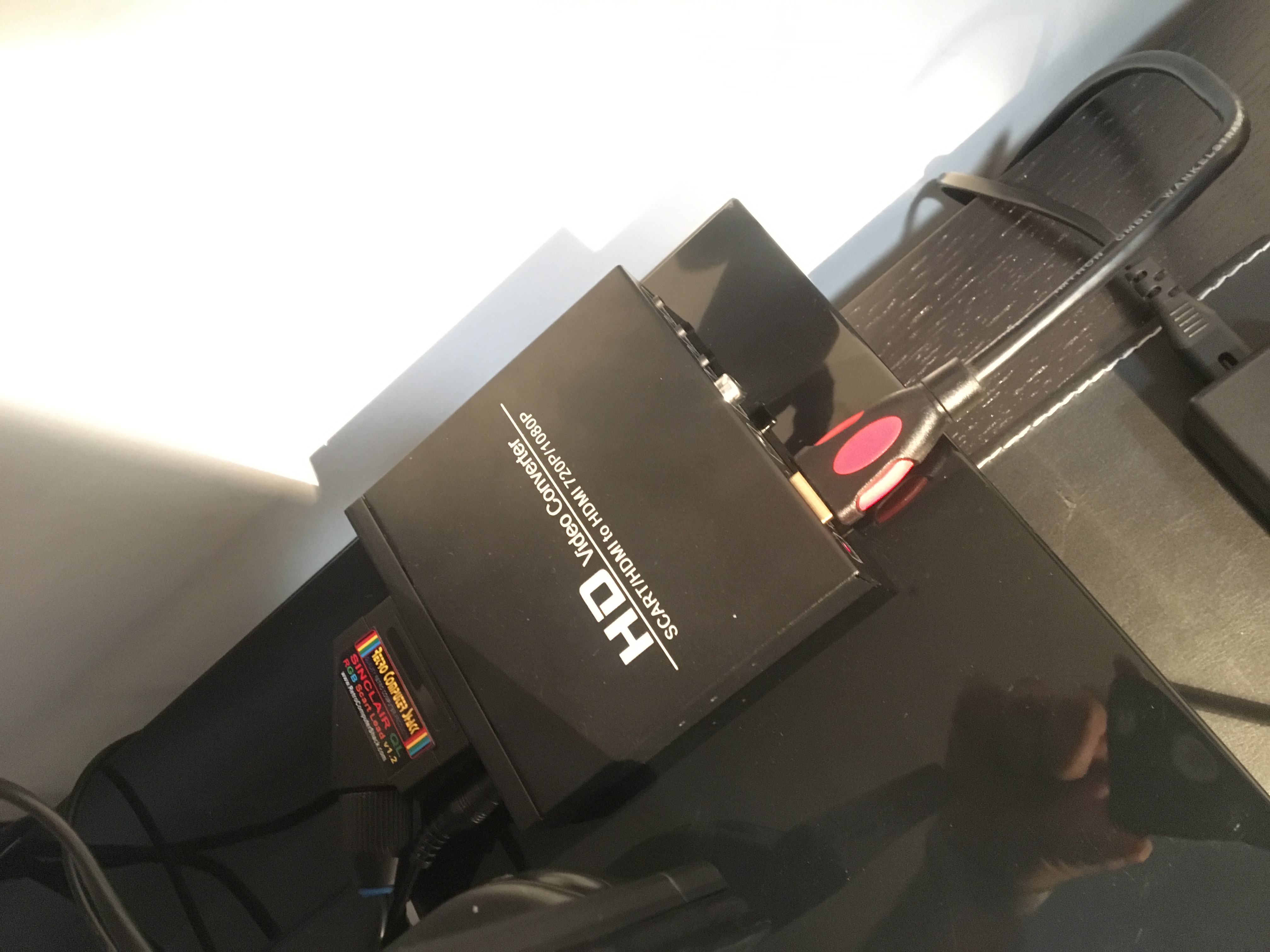

Solved with a scaler ! :P

Those cheap scalers are OK, though it depends upon the TV as to whether they will display the extra characters, most don't.
As for scalers being "fuzzy", well the cheap ones (which are really designed for video) do rubbish interpolation and also erroneously sharpen the image, so they don't look very good.

Erm, why would you ever use and OSSC with a MultiSync monitor?! It's designed to use HDMI to a TV. (That image was on a Curry's own brand FullHD LCD TV.) Of course, it depends upon your OSSC settings, the defaults don't digitise at double the pixel clock so you still get aliasing of the pixels and fuzziness and allowing passthrough output hands the upscaling to the TV/Monitor, which is usually hopeless.
I've got some of those convertors. They work but they are laggy as hell, so don't try to play games on them, and it's up to the TV to upscale, so if the TV does a good job you're OK. Also they merely detect the dot clock, digitise, fudge the de-interlace and send that information over the HDMI link and you hope the TV can handle it. They're not intelligent.
