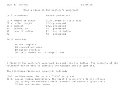

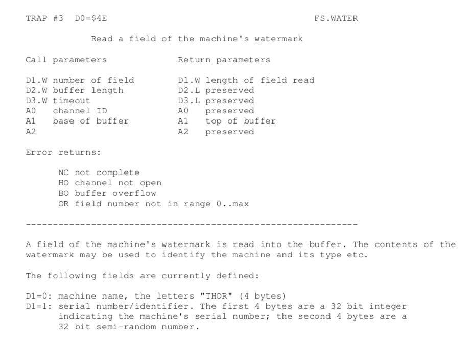

Now, looking in the Thor 1 technical manual, there is the following description of a Trap to read the Thor 1 serial number: So, referring to this entry of the TM, and since "ROHT" as ascii hex is 52 4f 48 54, we can see that the data in last two columns of data shown in the hex dump in Russ's post above correspond to the D1=0 machine name field; D1=1, and the first two columns contain the D1=1 serial number/identifier field, which consist of the 4 byte serial number, and another 4 bytes apparently consisting of a 32bit semi-random number!
