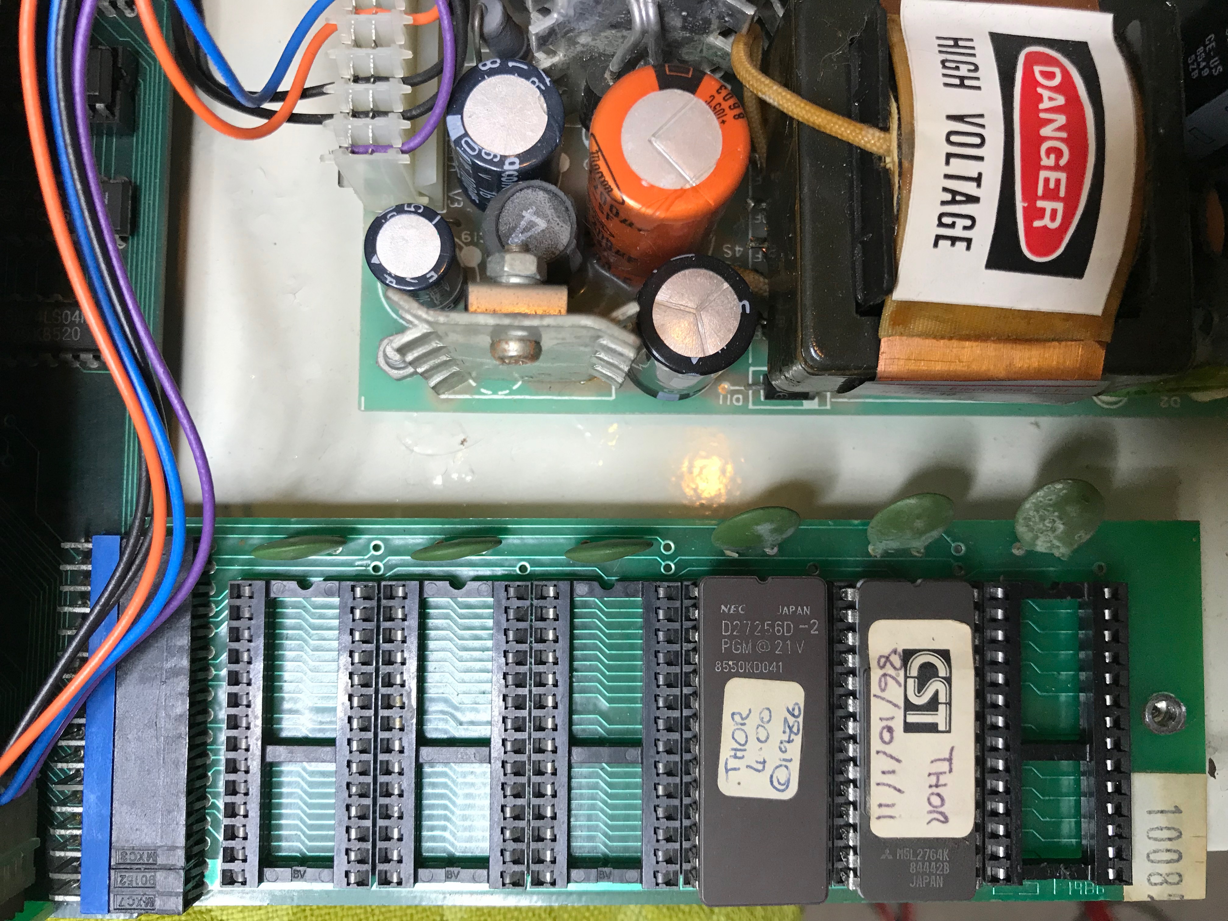

I therefore turned my attention to the two Thor EPROMs:
Placing the 27256 Thor 4.00 EPROM (the chip on the left, closest to the main PCB connector) in my TL866CS programmer, I was able to read the EPROM contents without any difficulty, and the data appear to be ok. However, the M5L2764K labelled CST Thor 86/10/1/11 (the computer's serial number) is another matter. This device is not in the supported device list for the TL866CS, but the M5L2764K datasheet states that this chip is interchangeable with the Intel 2764, which is supported. However, when I try to read the M5L2764K using the TL866CS, I find that the device is almost entirely empty (just a long series of FFs), other than for a few bytes right at the end. My conclusion is that the M5L2764K has become corrupted, and that the faulty contents of this EPROM are preventing the Thor from booting, though I suppose that there could be some incompatibility in correctly reading from this EPROM using a TL866CS.
Now, I'm not clear what, aside from the machine serial number, was stored in this M5L2764K CST Thor 86/10/1/11 EPROM - and the Thor Technical Manual doesn't shed much light on this. Looking at the Thor ROMs on Dilwyn's site, it seems that the contents of the 27256 are available there, but not the contents of the M5L2764K.

Meanwhile, I've tried the Thor 1 serial M5L2764K EPROM in the GQ-4X4 programmer - the 8k of data read from the chip are identical to the data when I read the chip using the Minipro TL866CS. The EPROM appears to be largely empty, though there are some unintelligible data right at the end of the file read from the chip - I can't believe that these are the correct contents of the EPROM, but I've uploaded the data file below, just in case these data make sense to someone...
The 32k NEC D27256 EPROM contains data that are very similar to the data in the Thor 8 ROMs on Dilwyn's site, though the ROM version in my machine is version 4.00, rather than the slight later versions in the archive.

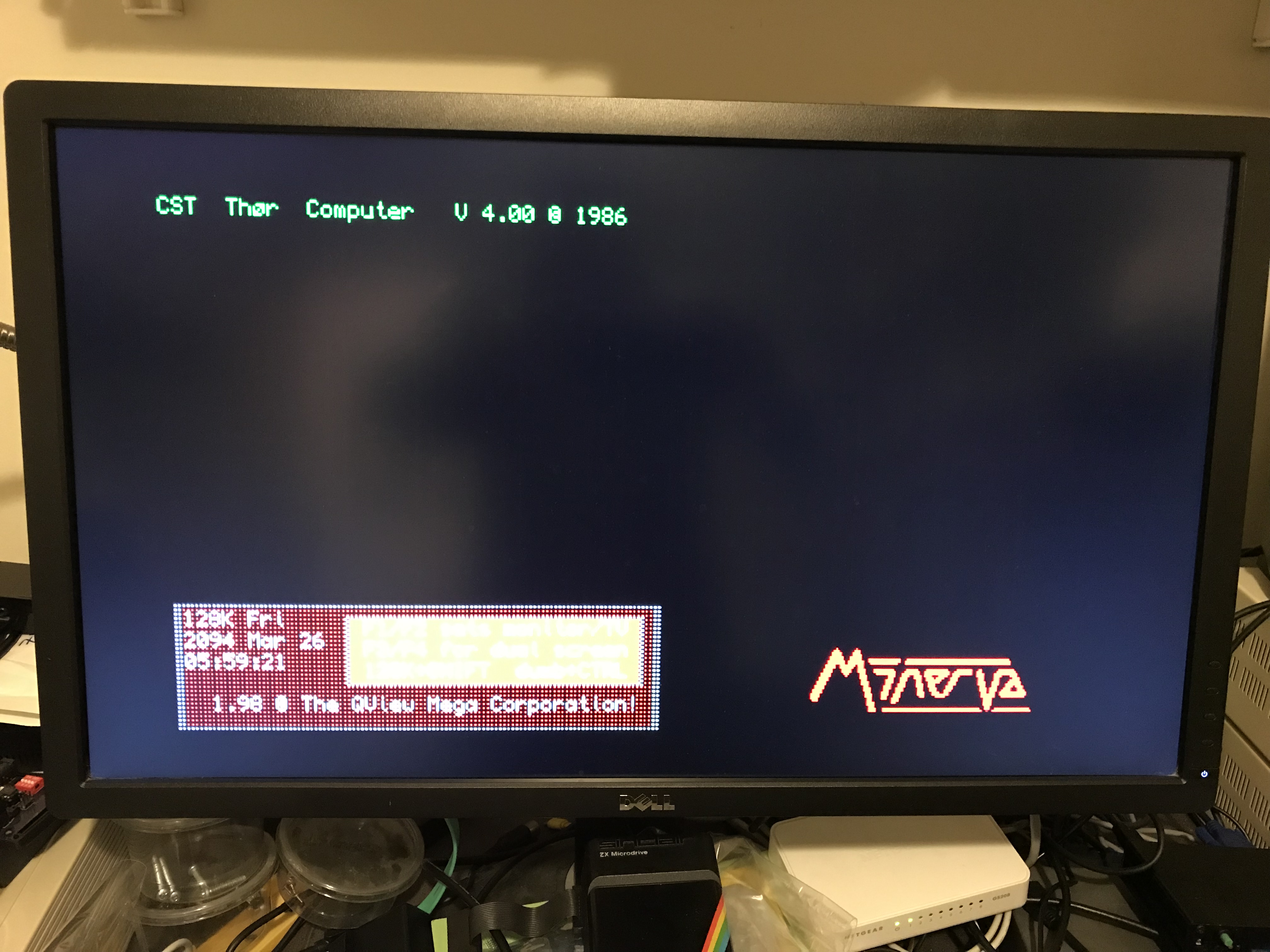

Just for interest - here’s what the screen currently looks like at boot on the Thor 1, with a Minera ROM:
Previously, the machine’s serial number appeared a couple of lines below the copyright message, but this now no longer occurs. The machine is unresponsive to keyboard input, and fails to drop into SuperBASIC. The horizontal coloured lines that I mentioned in the first post are no longer appearing. Switching over to the JS ROM doesn’t alter the machine’s behaviour.

I checked the Thor 1 eprom expansion board, it had the Thor v4.22 rom and another eprom with a faded label with a date written.
The eprom with the date label, was a NEC 27128D. Reading the eprom with same eprom programmer as you. Gave all FF in all locations.
Could be corrupted, CST did employ copy protection on their interfaces.

$FF's is the blank state of an EPROM. All that has happened is that the EPROM has self-erased over time. The faded label is a clue to what happened.
You might need to get a known new EPROM image from elsewhere, and you might need to change the serial number if they used ACTUAL encryption - though they may have just used address and data bus re-ordering to achieve a level of complexity that in the late 80s was equal to encryption.
