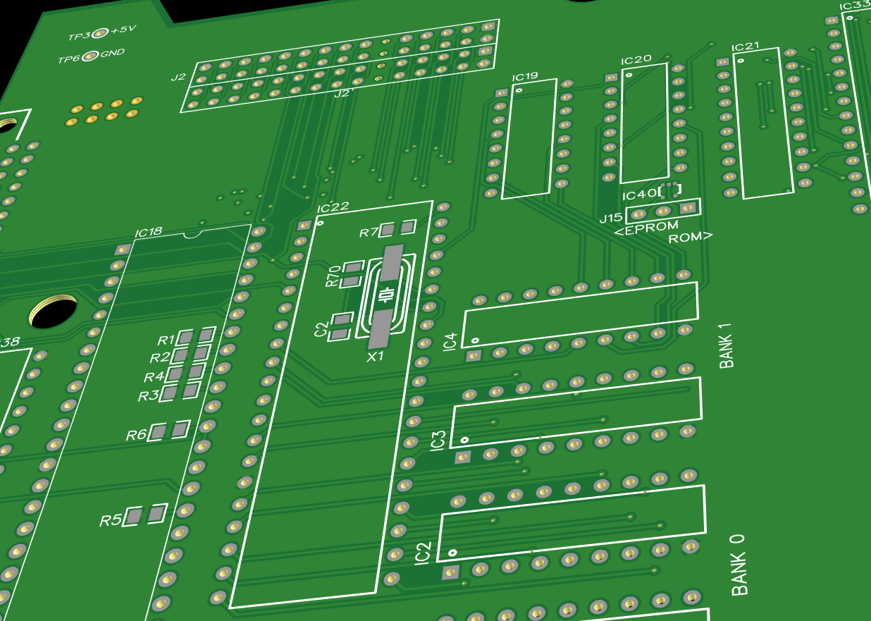

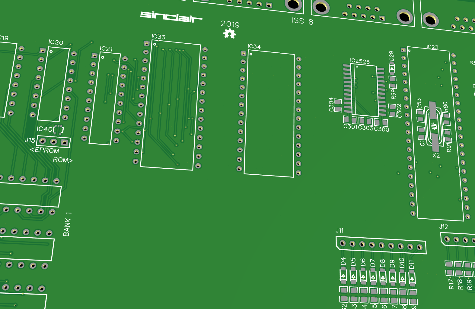

I made some progress.
Here's some 3D renders:
The CPU, 8301 and revised DRAM layout. Note DRAM is socketed, and bank 1 can be removed if you're using a SGC. Also, note the extra header row inside the ROM port, which also has a few extra pins - enough for an internal fast SRAM expansion if you want one. For the ROM slots, they have the exact position and spacing of the originals. Note the little jumper, so you can use QL JM/JS ROMs or an EPROM without using an adapter board. Also, the serial output has been switched from MC1488/1489 pair to ADM208EAR. The MC1488/9 required +/-12V, and it was easier to change the IC than incorporate those nasty power supply requirements. Also, note the serial and joystick ports are DB9 connectors... In black. RGB out is now fully buffered and protected. Power in is 9V from a standard 2.1mm power supply. If you have no expansions, a 500mA one will work. If you're going to plug a city of retro electronics into it, you might want a 2 or 2.5 amp 9v adapter. There is a power switch. And yes, those are QLNET ports. This is Issue 7.5, but I renamed it to Issue 8 because there are enough changes to warrant it - far more changes that between 5-6-7. However, you'll be amazed how much has stayed the same. The Issue 8 board I have been working on with Nasta is now called Issue X. It is wildly different. That does leave room for an Issue 9 in there, but again that will be a very different board to this one or any previous QL - though a lot more traditional than Issue X.
Other points of note are:
Battery backed RTC
Microdrives fully implemented, with microdrive out too!
Accepts standard membrane
100% Issue 7 compatible, no memory map or timing changes
4-layer board, fully debounced power, clean signals
This is the ONLY 100% original QL board I will make. I am buying the components to make 100 right now. Once the 100 are gone... They're gone.
Battery backed RTC

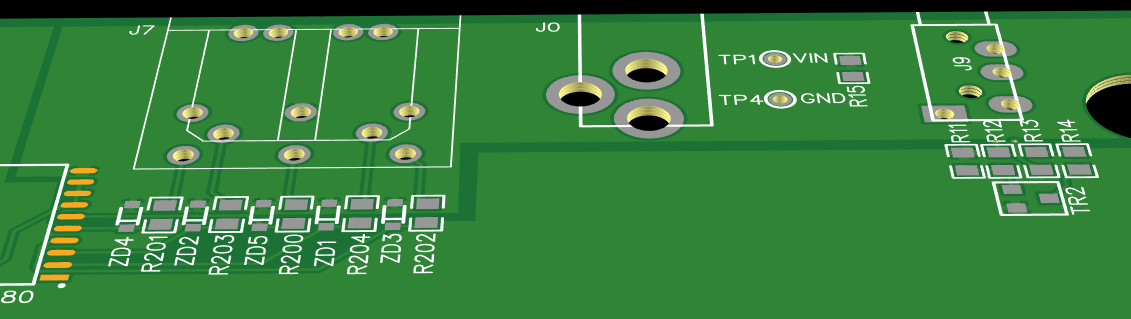

Great work Dave!Dave wrote:Power in is 9V from a standard 2.1mm power supply. If you have no expansions, a 500mA one will work. If you're going to plug a city of retro electronics into it, you might want a 2 or 2.5 amp 9v adapter. There is a power switch.
May I suggest some kind of reverse polarity protection at the power supply jack?
You know, a few Spectrums keep dying because the owner bought a new power supply and forgot to check the plug...
Re: QL test points...
The power supply will be added last, once I know exactly what the power requirements are. It will have a bridge rectifier so that no matter the polarity of the supply, damage won't occur. There will also be a DPST power switch, so both lines are switched together.
Don't use a bridge rectifier as it will have about 1.5V of voltage drop. A single Schottky diode in the right direction will protect the board - and if there is voltage and the QL does not work, that will be a clue to the user the polarity is wrong.Dave wrote:The power supply will be added last, once I know exactly what the power requirements are. It will have a bridge rectifier so that no matter the polarity of the supply, damage won't occur. There will also be a DPST power switch, so both lines are switched together.
Also, this is the better option for a simple and proper reset circuit, but I will discuss this in private (clue: TL7705 is widely available).
