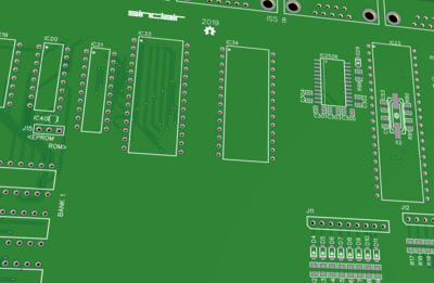

I made some progress.
Here's some 3D renders:
The CPU, 8301 and revised DRAM layout. Note DRAM is socketed, and bank 1 can be removed if you're using a SGC. Also, note the extra header row inside the ROM port, which also has a few extra pins - enough for an internal fast SRAM expansion if you want one.

For the ROM slots, they have the exact position and spacing of the originals. Note the little jumper, so you can use QL JM/JS ROMs or an EPROM without using an adapter board. Also, the serial output has been switched from MC1488/1489 pair to ADM208EAR. The MC1488/9 required +/-12V, and it was easier to change the IC than incorporate those nasty power supply requirements. Also, note the serial and joystick ports are DB9 connectors... In black.

This is Issue 7.5, but I renamed it to Issue 8 because there are enough changes to warrant it - far more changes that between 5-6-7. However, you'll be amazed how much has stayed the same. The Issue 8 board I have been working on with Nasta is now called Issue X. It is wildly different. That does leave room for an Issue 9 in there, but again that will be a very different board to this one or any previous QL - though a lot more traditional than Issue X.
Other points of note are:
Battery backed RTC
Microdrives fully implemented, with microdrive out too!
Accepts standard membrane
100% Issue 7 compatible, no memory map or timing changes
4-layer board, fully debounced power, clean signals
This is the ONLY 100% original QL board I will make. I am buying the components to make 100 right now. Once the 100 are gone... They're gone.
