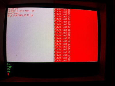

flaviosr wrote:Dears,
I already had the QL cable DIN RGB to SCART and I received today the SCART to VGA box you proposed!
I works great (I ordered version 2, that should be able to adapt more signal types) BUT I loose one column on the left and HALF a column on the right.
I am using a DELL monitor! :(
Any other suggestions? :(
Did you specifically ask for the QL modification when you ordered the video scaler?
When you do , they fine tune it following their previous experience with the QL although they don’t have an actual QL and maybe it’s not always exact.
Your lucky your monitor accepts 50 hz!
Enviado desde mi iPhone utilizando Tapatalk
Ok... the mistery is solved. I received the following answer:
The QL modification was to bring more of the picture on the left in to view, and as much as possible for the right side. The QL goes deep in to the “overscan” areas of the TV picture, areas which were there to help older TVs operate without showing a visible border on the screen. It’s an area which would normally be avoided, but Sinclair designed the QL to use this area.
We have a version of the firmware that we can reprogram your converter with to improve the performance with the QL. We just need you to return the converter to us. The modification is free, we love our old computers too, but we’d have to charge for return postage (sorry!).
Now I have to check if it's convenient to ship the box back from Italy... :(
I have an idea. Why dont you ask for another one with the QL modifications and sell the one you have to any italian user of retrocomputers. There must be thousands, in need of a way to connect old rgb computersImage

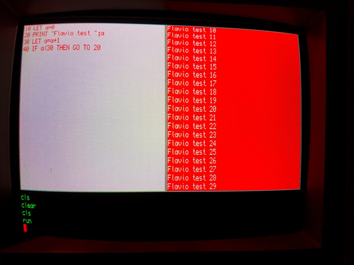

It seems a very good idea! My idea was to keep it anyway for "other" computers hoping the UK Company would prepare a more programmable box.
Now I test the box with other computers (Amiga, Olivetti) and then I decide.
I also tried the QL with its RGB=>SCART cable with an old monitor (a Philips one) and the image quality is more then perfect!
Now I go and search for a MDV1_ replacement...

Great image! Lucky to have a monitor with scart input. We don’t see them in america
Why not?
Commodore ones? Atari ones? I have a Philips and some Commodore... I remember that when I was looking for one, some were sold in the US!
And... I an old post you wrote I am luck that my monitor get the 50 Hz? What do you mean...?

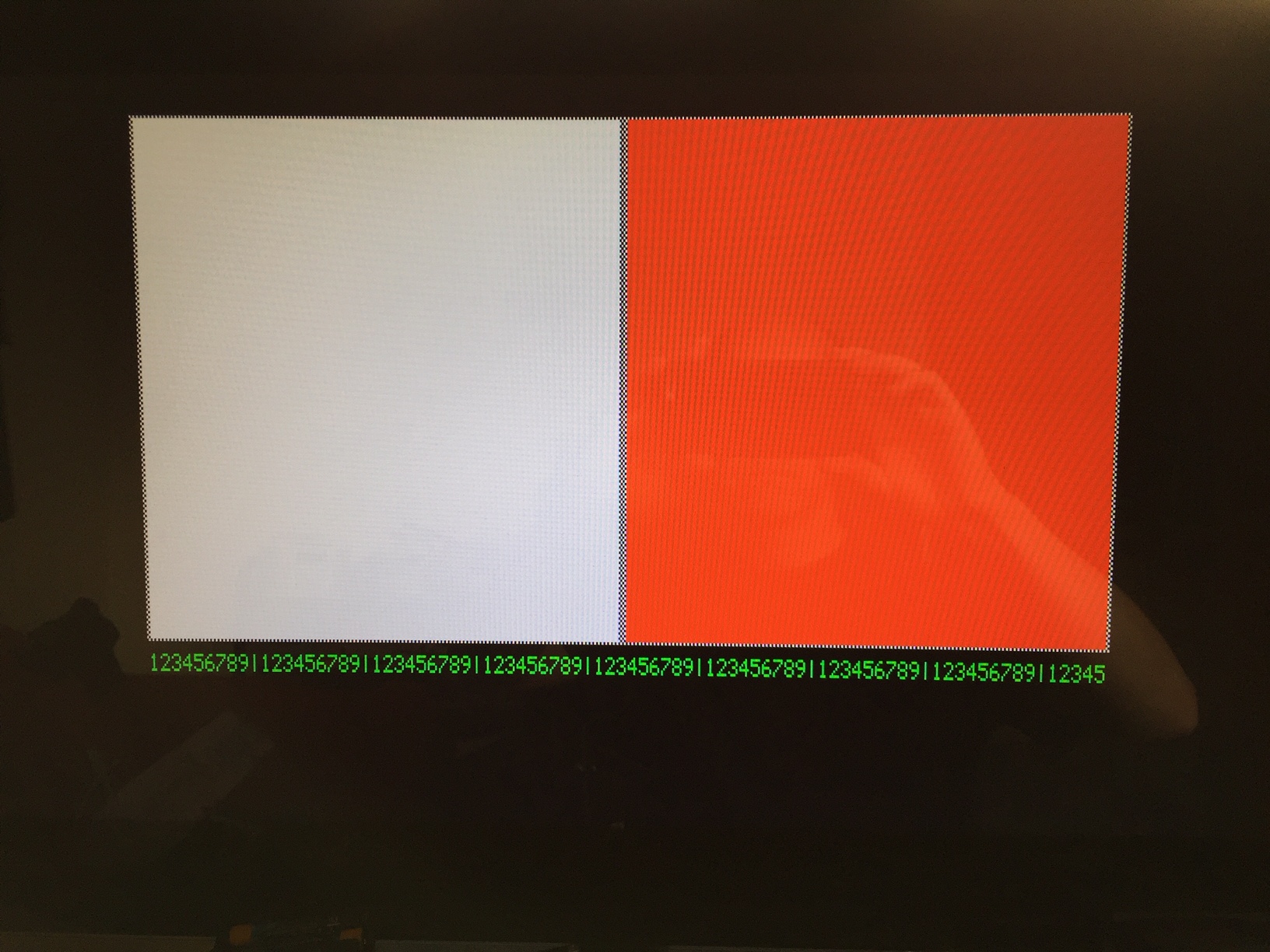

Last week I took possession of an OSSC (Open Source Scan Converter) so as to allow my Atari TT, which has a non-standard VGA output, to display well on modern TVs/displays. The OSSC has a variety of inputs, including VGA and SCART, and outputs to HDMI.
Now, the device isn't cheap, costing just under £200 including the delivery, remote control and 5 volt power supply.
Well, this evening I thought that I'd try hooking up the QL to the SCART interface and this was the result on my cheap Full HD TV...
This scan converter has almost zero lag, which is great for games, unlike the cheap scan converter I've used previously. Also the output is amazingly sharp.
If you're interested you can buy one here: https://www.videogameperfection.com/pro ... converter/

Posts: 2542
Re: Issues and questions.
The picture looks better than anything else I saw generated from original QL video. (At least from my QLs - there seem to be video quality differences between mainboards.)
Can the black borders be removed?
Is there a closed case also?
