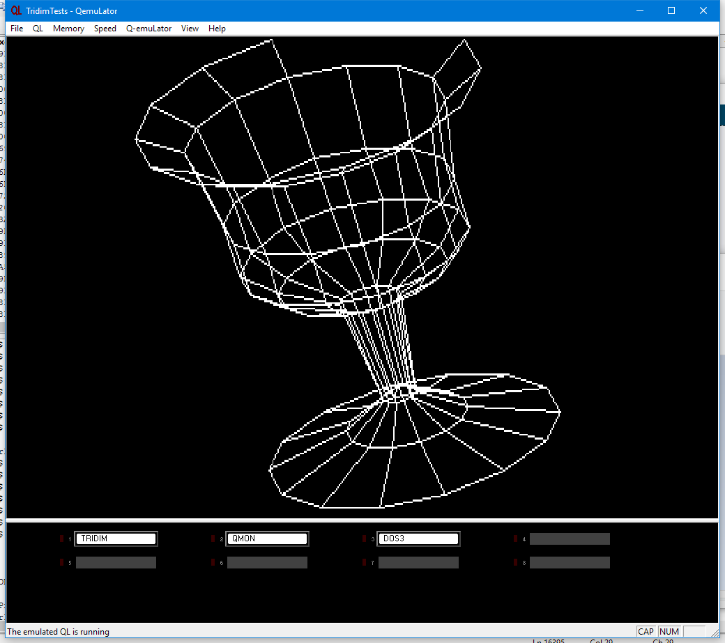

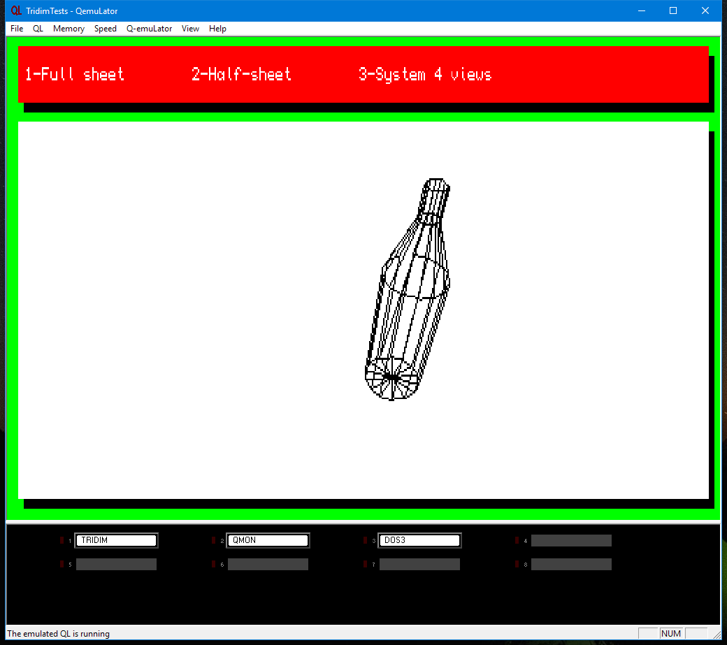

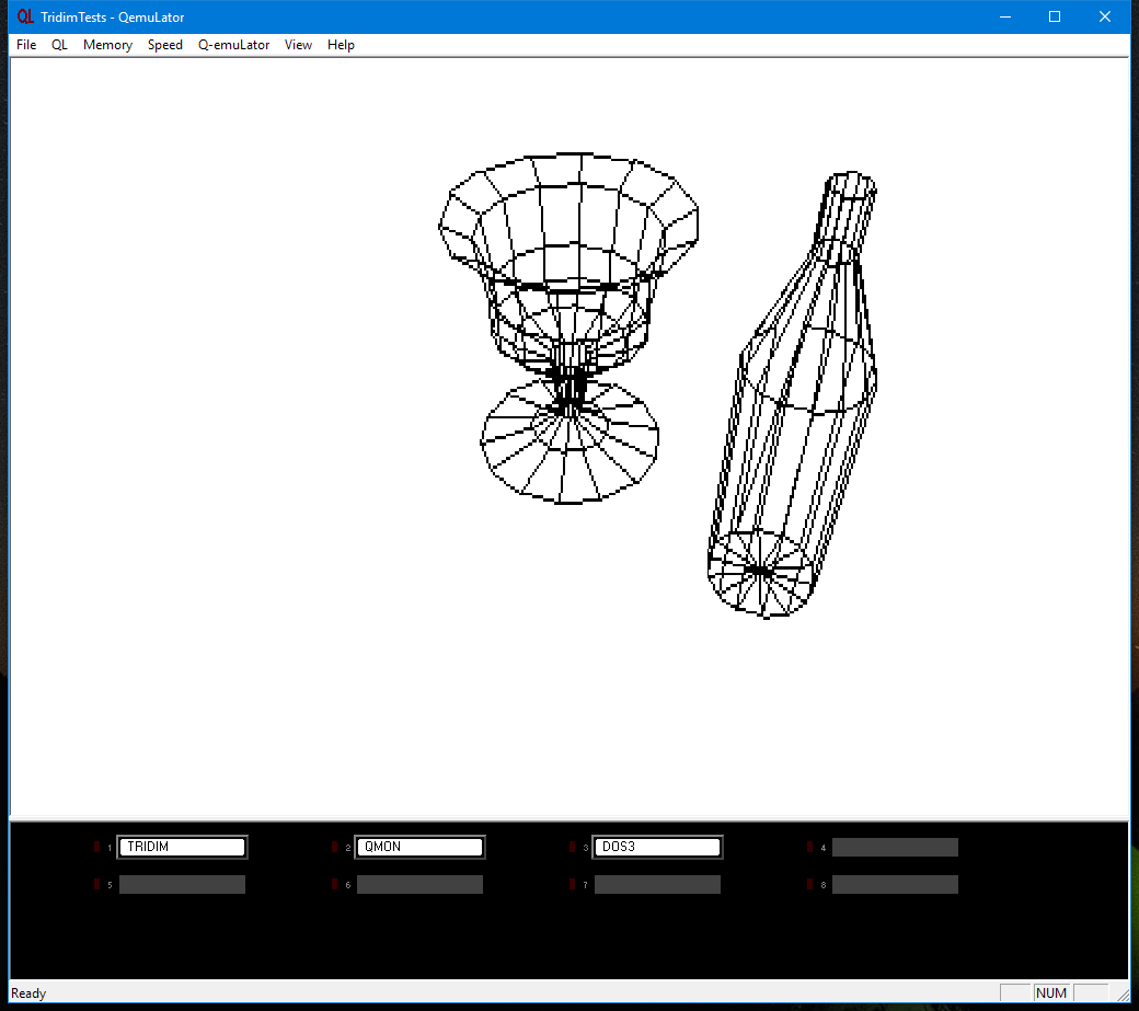

Another update.
I have attached an English translation of the program, and a user manual. Both are still a work in progress. So don't take them as finals.
I have only translated the Boot programs and the main Tridim_exe so far, So let me know if you find any bits of French I have missed.
After loading the program, it takes about 20 seconds for the main menu items to appear.
Sometimes the program does not draw correctly, I don't yet know what's causing that yet, but as you can see, it can work.
This is doing the worked example, and the last picture is from the Handling program.
