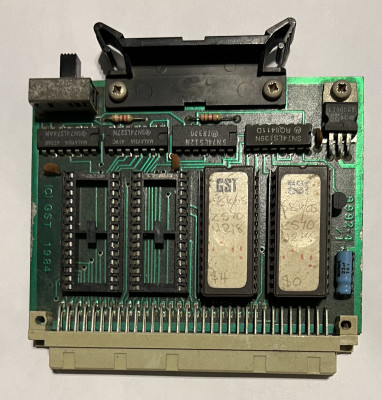

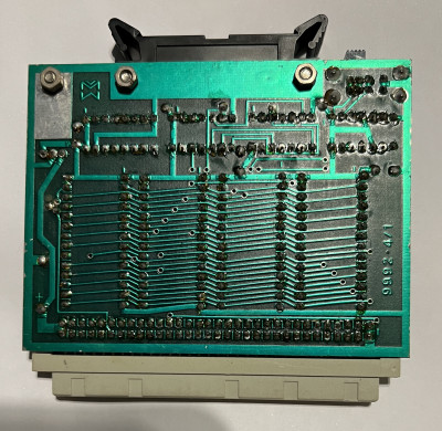

I don't know if there is interest, but if you post somewhere pictures of the PCB, both sides, I will do my best on reverse engineering it, to preserve the schematic and share it for future repairs or whatever.

Okaalea wrote: Sat Apr 27, 2024 12:59 pmI don't know if there is interest, but if you post somewhere pictures of the PCB, both sides, I will do my best on reverse engineering it, to preserve the schematic and share it for future repairs or whatever.

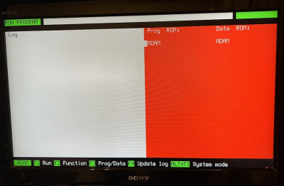

It's arrived and appears to be alive!
Next up is to re-felt the OS MD's (there's an original & a backup)
Re: 68k/OS additional ROMs
As requested (best I can do)

A quick update
The backup 68K/OS mdv was bad, luckily the original master was good (not tried actually running all the programs though)
I had a hell of a job making backups to start with (both my QL's currently only have 1 fully working MDV each) and it didn't seem to want to format on the known good drive
Turned out it was the vMap fitted to the QL that was causing the formatting issues, as soon as I removed that I could format fine
So I now have 4 good backups of the software
Not sure when I'll get time to try using it in more detail

I try to recreate it, the actual work can be see here: https://github.com/alvaroalea/QL_GST_Rom_board , is a kicad project, so can be open with this free software, or there is pdfs of schematic and board.t0nyt wrote: Tue Apr 30, 2024 11:41 amAs requested (best I can do)aalea wrote: Sat Apr 27, 2024 12:59 pm I don't know if there is interest, but if you post somewhere pictures of the PCB, both sides, I will do my best on reverse engineering it, to preserve the schematic and share it for future repairs or whatever.
What I got, pending to read the other long topic, is confusing, I can not see correctly the part of the switch, is not clear to me if it is a 2 position or 3 position switch, and not clear what happend, (perhaps Alwais ON, change on reset, Alwais OFF). there are some tracks that can not draw correctly.
Also it seen to be mapped on the the area of 0x40000 to 0x4FFFF (4 chips of 16Kb, 27128) and that means that will be incompatible with any card with RAM, it also mean that QDOS do not search in this space for any ROM, so if populated with TK2, ICE or other toolkit, will not appear on boot.
I suspect that is only usefull with 68K/OS and wondering if 68K/OS is intend for only use 128Kb of RAM.
It’s a 3 position switch though I don’t understand the middle positions difference to rear position
Rear position = qdos
Middle position = qdos
Front position = 68k/os
Nothing Qdos related is applicable in 68k/os mode as it completely takes over the machine (only the mdv’s are relevant) so tk2 etc. have no relevance to 68k/os.
It expects to find a ROM disk at $c000 (or nothing)
With regard to memory expansion I’m not sure. I have a quintupler memory expansion (chr$) and 68k/os works regardless of whether it’s enabled or disabled but I don’t know yet how to find out how much memory it’s actually seeing!
