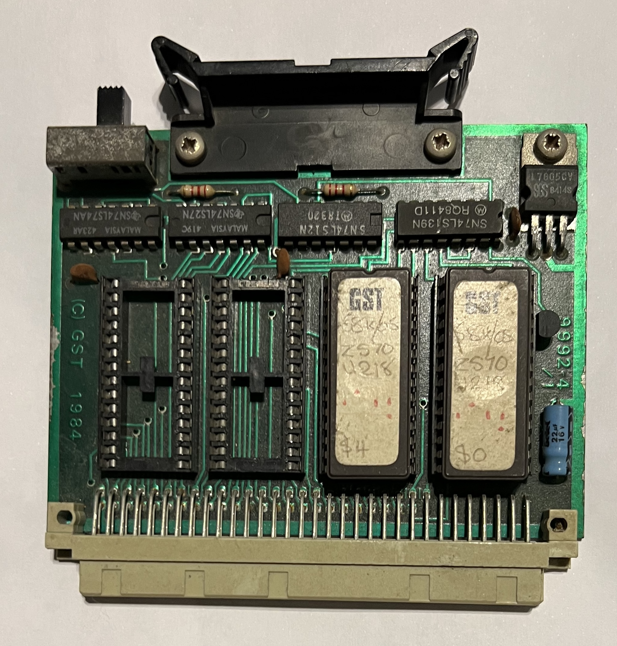

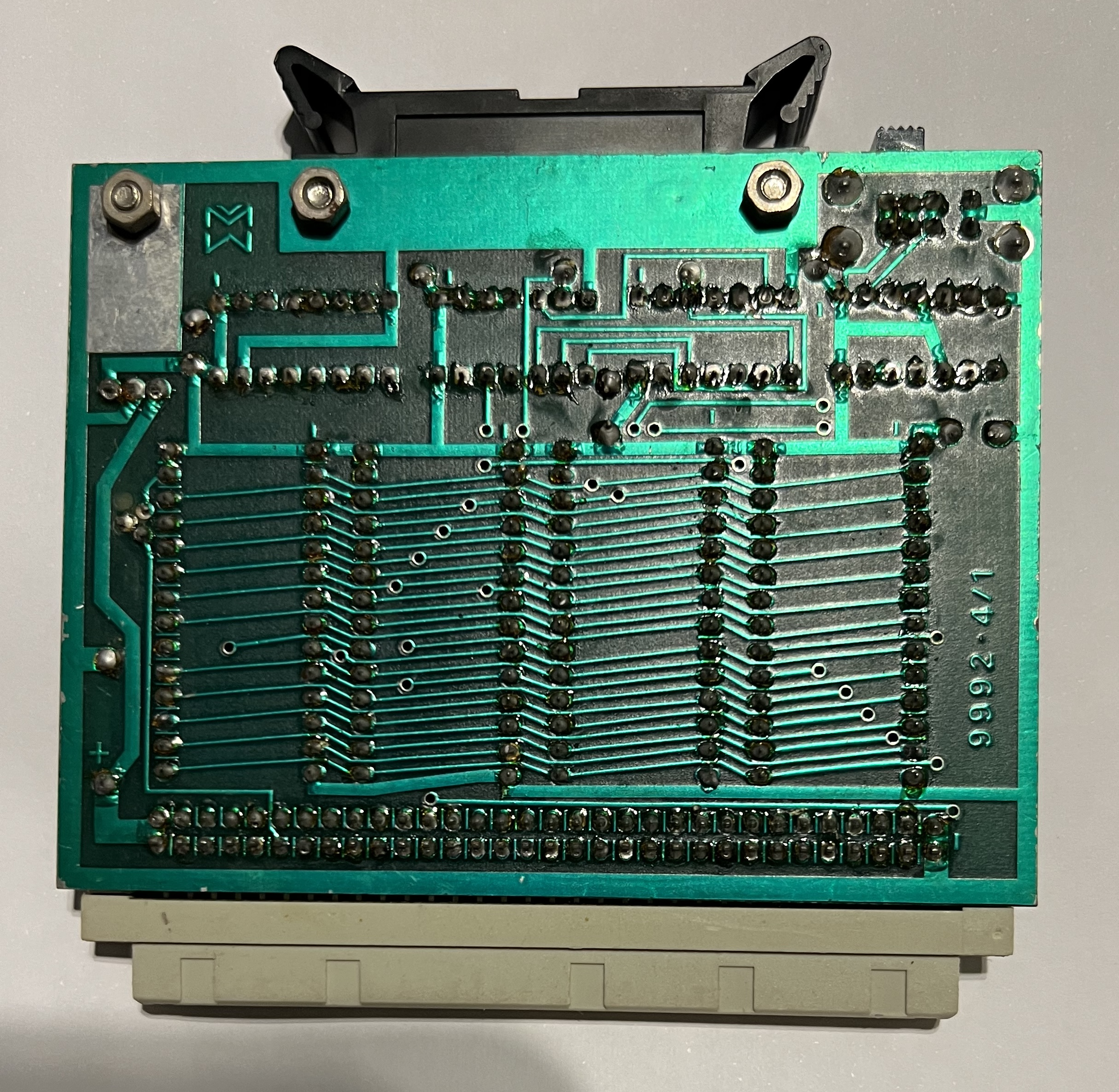

t0nyt wrote: Thu Apr 25, 2024 9:20 am So, yes, I purchased the 68K/OS as it intrigues me
I don't know if there is interest, but if you post somewhere pictures of the PCB, both sides, I will do my best on reverse engineering it, to preserve the schematic and share it for future repairs or whatever.

As requested (best I can do)

t0nyt wrote: Tue Apr 30, 2024 11:41 am
aalea wrote: Sat Apr 27, 2024 12:59 pm I don't know if there is interest, but if you post somewhere pictures of the PCB, both sides, I will do my best on reverse engineering it, to preserve the schematic and share it for future repairs or whatever.
I try to recreate it, the actual work can be see here: https://github.com/alvaroalea/QL_GST_Rom_board , is a kicad project, so can be open with this free software, or there is pdfs of schematic and board.
What I got, pending to read the other long topic, is confusing, I can not see correctly the part of the switch, is not clear to me if it is a 2 position or 3 position switch, and not clear what happend, (perhaps Alwais ON, change on reset, Alwais OFF). there are some tracks that can not draw correctly.
Also it seen to be mapped on the the area of 0x40000 to 0x4FFFF (4 chips of 16Kb, 27128) and that means that will be incompatible with any card with RAM, it also mean that QDOS do not search in this space for any ROM, so if populated with TK2, ICE or other toolkit, will not appear on boot.
I suspect that is only usefull with 68K/OS and wondering if 68K/OS is intend for only use 128Kb of RAM.
Posts: 1116
Re: 68k/OS additional ROMs
It’s a 3 position switch though I don’t understand the middle positions difference to rear position
Rear position = qdos
Middle position = qdos
Front position = 68k/os
Nothing Qdos related is applicable in 68k/os mode as it completely takes over the machine (only the mdv’s are relevant) so tk2 etc. have no relevance to 68k/os.
It expects to find a ROM disk at $c000 (or nothing)
With regard to memory expansion I’m not sure. I have a quintupler memory expansion (chr$) and 68k/os works regardless of whether it’s enabled or disabled but I don’t know yet how to find out how much memory it’s actually seeing!
