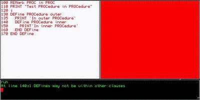

(1) Error is: At line nnn:nn DEFines may not be within other clauses
For an example see the attached screenshot

yes, that's true. SBASIC checks against a number of possible quirks in programs that SuperBASIC didn't care about - A fact that has mostly been considered a bug in the interpreter. One of those is the proper nesting of PROCs and FuNcs.
Other languages like Pascal or MODULA allow you to basically hide a PROC or FuNc within another one (so that it will only be known to the construct it is contained in, and this is sometimes very handy, because you can also share local variables between inner and outer construct) - This is not the case in SuperBASIC, if you use such nesting there, the inner construct will still be known to the rest of the program, so there is actually not really a point in doing it - Most S*BASIC programmers would thus consider this bad practice. (At least to my eyes, it looks weird
Compilers like TURBO will btw not accept such constructs as well (QLiberator will most probably happily compile) - So if you want to use Turbo or run on SMSQ/E, you should keep your definitions properly apart.

Nested procedures arent implemented either in SuperBASIC or SBASIC. A lazy interpreter let a cheeky programmer get away with it in the instance above. A shame, its a nice idea.....
DeFine PROCedure something
DeFine PROCedure pat
do something
END DeFine PROCedure
