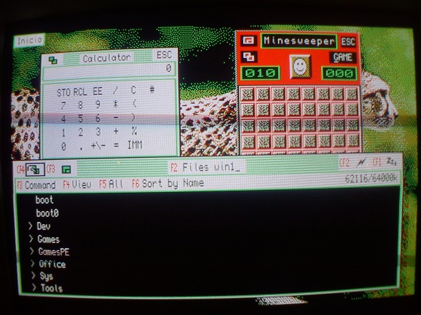

My QL has already a QubIDE clone.
Jose_leandro has produced the first batch, this is mine:
QubIDE clone - eprom minerva+tk2
The kit is supplied with 512 KB RAM, eprom minerva+tk2 (optional) and software to transfer files from the PC (programmed by Habi).
The clone works fantastically, it is very stable and reliable. (Also it works fine with QL-SD).
Some photos:
Jose_leandro QubIDE clone, first batch
Test in my QL (QubIDE clone + QL-SD)
SD-IDE, DiskOnModule - tested

Just to add, what are you running with the nice leopard/cheetah desktop on? Standard QL?
