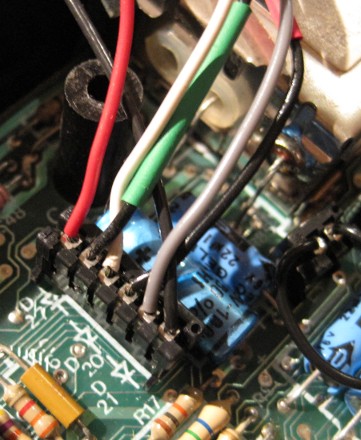

Eek help please i recently acquired a ql and with no keys working I have taken apart to inspect the membrane which I have discovered is cracked along the crease on one of the ribbons, problem is the collection of 6 or so wires which attach to a small black plug on the main board have detached from their little black plug (my fault trying to unplug it) and I didn't take note as to which order they were in, think there is a red,white,grey and a few black wires, any help appreciated, thanks.

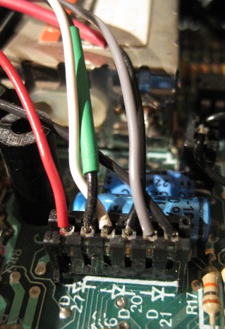

Re: Keyboard to pcb wires pulled out by accident, oops
Pin Wire Colour Function
1 Black MDV2 (red)
2 Grey
3 Black MDV1 (red)
4 White
5 Black POWER (yellow)
6 Red

Just a note about the wires - it does not matter about the order of the black wires - they are all common ground, so can be in any order - is it the red, white and grey leads which need to be in the right order
Superb advice and pictures thanks very much, seems I haven't destroyed it after all phew, sorry for being a noob but what's the best way to reattach the wires, does the black plug detach from board or do I just push the wires back in to it ? Thanks
- RWAP Master
- Posts: 2893
The black plug lifts upwards (grab the two ends and lift it up - it does not come clear of the motherboard), insert the wires and then push it back down to clamp the ends of the wires.
Be patient - 9 times out of 10, one of the wires will still be loose - give each a gentle tug to ensure they are held properly - otherwise, one will come out when you put the QL back together!
Just remember that pin 1 is not the top one; actually top to bottom is 6, 5, 4, 3, 2, 1. Guess who managed to mount the wires the wrong direction...
