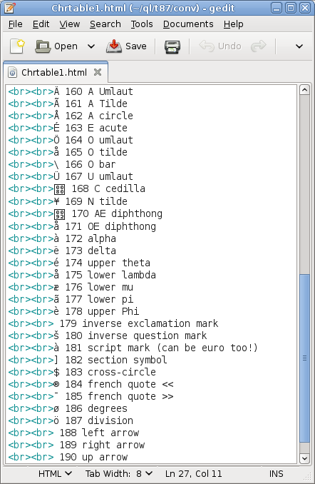

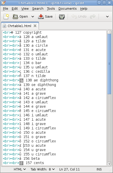

Re: SBASIC / SuperBASIC Reference Manual - HTML
Rich,
Here is the result of your dump. Unfortunately I cannot squeeze all characters into latin1, some codes overlaps and some have plain ascii meaning, so I picked those I felt most frequent. E.G. capital A grave I sucrificed to a circumflex. Arrow keys use control codes ESC,^Z,^X,^Y, so I do not map these for the time being.
Please see the result.
Not sure if this can be improved further with UTF8 encoding.
I am also sending next batch run to you. I realise some parts of the manual have been edited already so I hope this will mainly affect Appendices 8,9, Keywords K.
Tom
Tom
