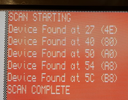

New code
100 WHEN ERRor
110    f=0
120    CONTINUE
130 END WHEN
140 PRINT "SCAN STARTING"
150 c$=CHR$(164) & CHR$(255)
160 FOR x = 0 TO 127
170    f=1
180    r$=I2C_IO(c$,0,x,0)
190    IF f=1 THEN PRINT "Device Found at " & HEX$(x,8) & " (" & HEX$(x*2,8) & ")"
200 NEXT x
210 PRINT "SCAN COMPLETE"
Sample output
Posts: 1174
Re: Adventures with I2C & Minerva Mk2
The scanner has thrown up an issue with the AT24C256
It shows as both &54(&A8) AND &5C(&B8), confirmed as when unplugged both devices vanish
&54(&A8) works fine with both test programs
&5C(&B8) corrupts the end of the "page test" text
I thought maybe it was writing to Minerva, but on checking settings they hadn't been corrupted
Reading the data sheet I can't work out why this is happening
Any thoughts on how I could troubleshoot this please?
Tony

Posts: 1174
t0nyt wrote: Mon Sep 08, 2025 10:25 am The scanner has thrown up an issue with the AT24C256
Tony
I bought a 5 pack of these and I just tried the other 4 and even using the correct address they don't work properly
The fact that 1 seems to work, on proper address, makes me think these are a cheap knock off
Will order another from somewhere more reputable to test

Posts: 1618
Tony
What have you got the 3 address lines tied to on these NVRAM's ? Don't leave them 'flapping' or unconnected. You need to set at least one of these pins to 5v logic 1, so that you avoid contention with the RTC chip, you may also need to avoid other chips that have clashing addresses.
Posts: 1174
Pr0f wrote: Mon Sep 08, 2025 12:37 pm What have you got the 3 address lines tied to on these NVRAM's ? Don't leave them 'flapping' or unconnected. You need to set at least one of these pins to 5v logic 1, so that you avoid contention with the RTC chip, you may also need to avoid other chips that have clashing addresses.
A2 is tied to 5v and A0/A1 tied to ground (to avoid clash with Minerva NVRAM)
No other clashes (and it's the same with just this 1 device attached)
Thanks
Tony
Posts: 1618
Have you got a picture of the chip to see what the label looks like?
You did mention the possibility of them being suspect...
