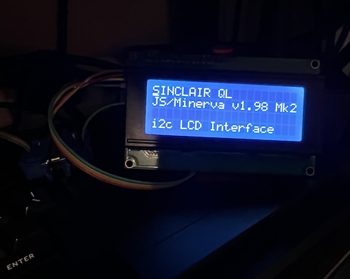

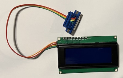

There's a multitude of i2c LCD displays so I chose a simple 4 lines x 20 characters as my first i2c device to try
Having blatantly copied the code by MartinB on StarDot it proved to be straightforward, so I assume other displays will hopefully be just as simple (maybe not the matrix style that I've not tried yet)
A typical 4x20 LCD (with harness attached)
The reverse shows the PCF8574 GPIO extender board for the i2c (this is a TI version with ID &27, NXP's use &3F)
A simple basic test program
Example output

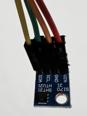

Next up was an HTU-21D Temperature/Relative Humidity sensor
Device id &40
This was the first device I tried where information was being read back and it proved to be a difficult learning curve (see post viewtopic.php?t=5402) and hair puller (not that I have that much now) so a big thanks to those who contributed
The main problem, having worked out the i2c_io syntax, was that Minerva Mk2 doesn't implement clock stretching so i2c_io didn't wait for the measurement to be made before trying to read the result. So it was necessary to split the measurement request and read request into separate i2c_io commands and pause in-between them

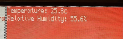

The test code
And the output

Device id &40
The test code
100 c$=CHR$(164) & CHR$(HEX('FE')) & CHR$(255): REMark Soft Reset
110 r$=I2C_IO(c$,0,HEX('40'),1)
120 PAUSE 20 : REMark pause after reset?
130 r$=GetValue("T"): PRINT "Temperature: " & r$ & "c"
140 r$=GetValue("H"): PRINT "Relative Humidity: " & r$ & "%"
150 DEFine FuNction GetValue(V$)
160 LOCal e,v,c$,r$
170 SELect ON V$
180 ="H","h": e=HEX("E5") : REMark Relative Humidity
190 ="T","t": e=HEX("E3") : REMark Temperature
200 END SELect
210 c$=CHR$(164) & CHR$(e) & CHR$(255)
220 r$=I2C_IO(c$,0,HEX('40'),1)
230 PAUSE 200 : REMark WHAT PAUSE NEEDED???
240 c$=CHR$(2) & CHR$(188) & CHR$(255)
250 r$=I2C_IO(c$,3,HEX('40'),1)
300 v=CODE(r$(2 TO 2))
310 v=v&&253 : REMark strip status bits
320 v=v+(CODE(r$)*256)
330 SELect ON V$
340 ="H","h": v=-6+125*(v/65336)
350 ="T","t": v=-46.85+175.72*(v/65536)
360 END SELect
370 v=INT(v*10)/10
400 RETurn v
500 END DEFine
And the output

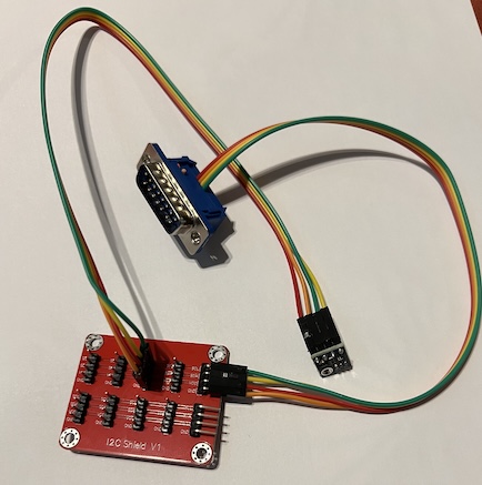

To save swapping connection harnesses around (or making new ones as it's fiddly work) I've attached one of these breakout boards
It also saves me having to look up my colour codes every time I swap things around too
Will also allow adding more than 2 x i2c devices when playing around (assuming QL can supply enough power!?)
