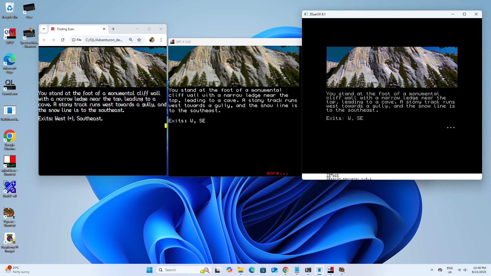

In the meantime, my experimental DAADReady conversion to QL SuperBASIC has progressed to a point where I can recreate a working adventure from the DAADReady output from Adventuron (i.e. the TEST.DSF file and "Images" folder). It still needs some manual input, as I still don't fully understand the workings of DAAD, and needs some small bodges to work. In fact, it came as quite a shock that it actually worked at all! I don't think it will ever reach the point of being a tool worthy of release, but I'm happy to share it with anyone who is remotely interested.
The whole point of it, is that you can write your adventure in Adventuron (selecting 8-bit compatibility mode, and creating graphics in 8-bit colour to the required dimensions), then compile to HTML (which you can share easily!). Then export to DAADReady format, which can then be compiled to run on a range of 8-bit machines, and in particular Spectrum Next, which uses 8-bit colour. Then you also have the option to use this utility to convert DAADReady to QL format too. That will rule out Modes 4 and 8, but Q68 and emulators running SMSQ/E will be able to run it. Also the QL core of Spectrum Next (when it's finished at some point in the future).
To test it, I manually re-wrote my Finding Evan adventure in Adventuron and saved it (eventually) in all three versions, see below. There are some differences here and there, which I hope to iron out, but none that affect the ability to play the game.
[Edit... L-R: HTML (on Chrome), QL (on QPC2), Spectrum Next (on ZEsarUX)]
Alan
