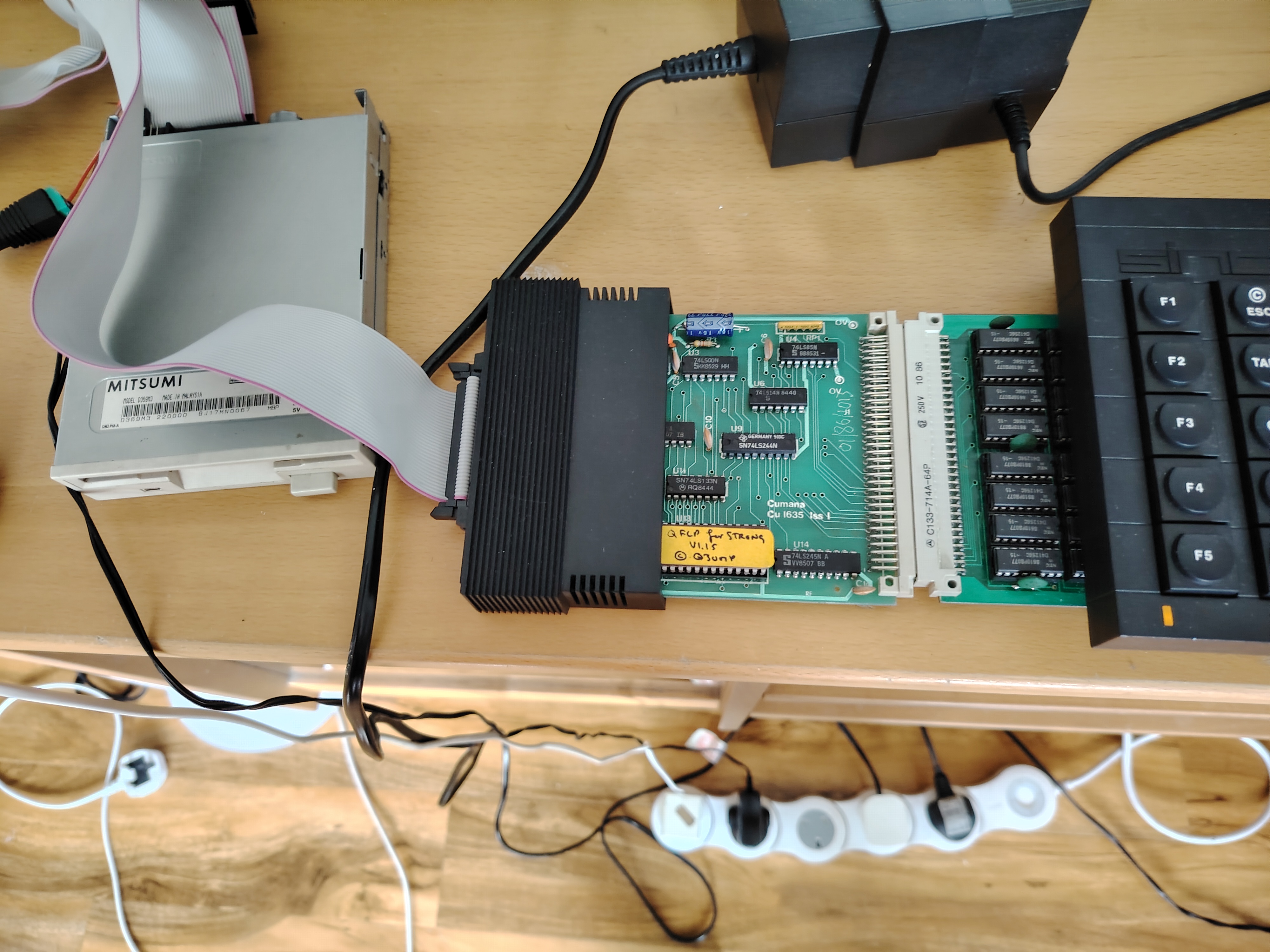

With my set up If I try and format a floppy disk in the ql it will sound like it is doing it but says format failed at the end.

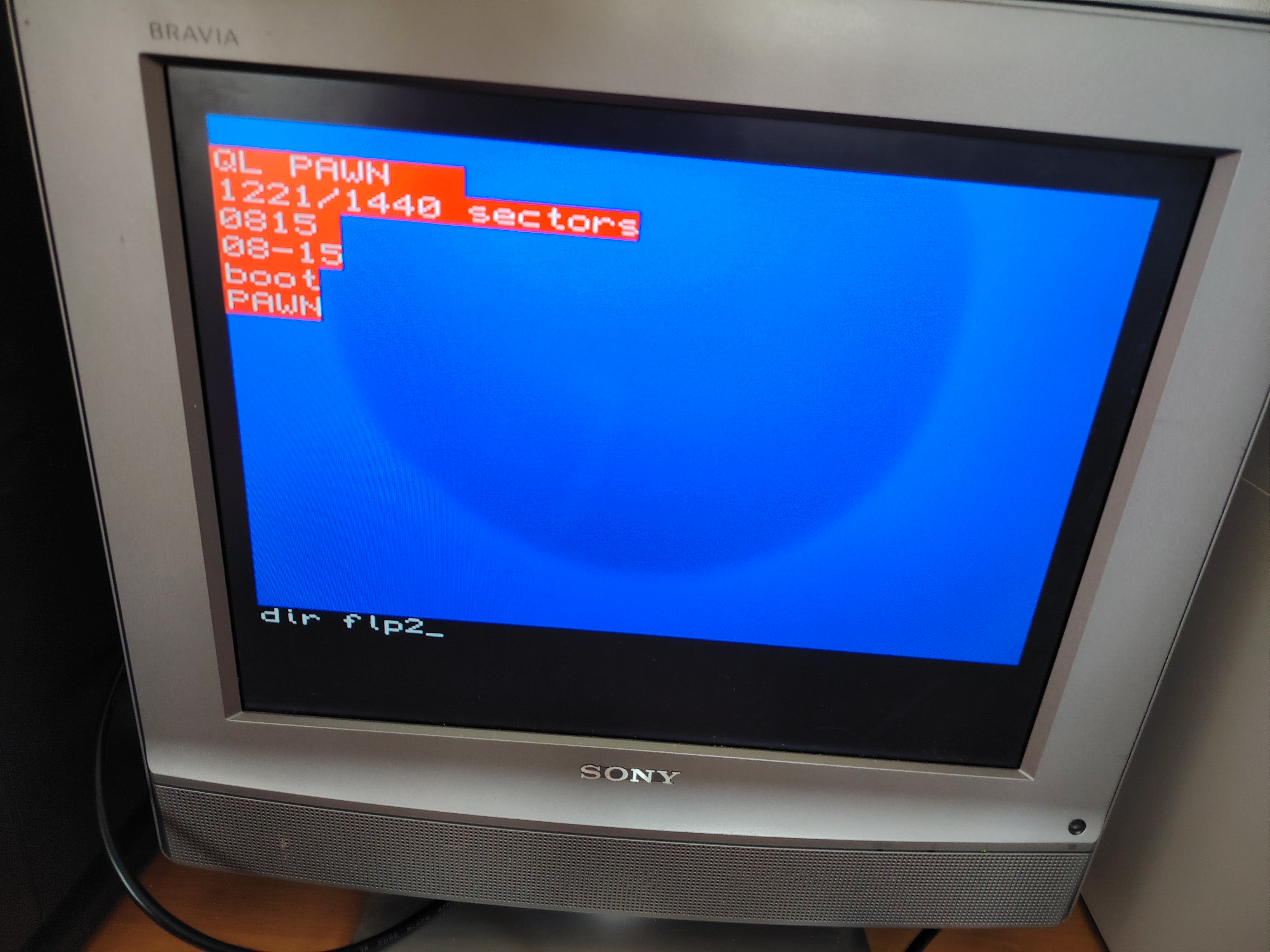

I found a website which had a ql disk image which I have placed on a floppy via my greaseweazle using flash my fluffy floppy and if I search the directory on my ql it does see it. But the ql will not autoboot the external floppy and I have tried lrun and load commands but nothing works to run the disc.
What am I doing wrong.

Has you check with other floppy drive? I have some that do not allow me to format disk, I think they are not correctly calibrated.
I wonder about the sticker of the ROM, I do not know that Cumaná need a new ROM, I was thinking this was only for microperiferical (Sinclair's ones)
