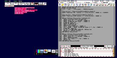

I have tweaked and compiled the snippet of code Dilwyn Jones supplied. The image shows the code and the outcome indicating that the program
hangs after Q_ERR_ON was set and when error trapping OPEN_IN.

Artificer wrote: Sat Jul 12, 2025 11:54 am QERRON.JPG
Q_ERR_xxx figures largely in the Qlib compiler itself..
