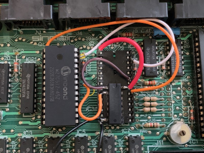

Here's how to make a ROM adapter:
What you will need:
Bend all the pins except pin 7 of the 74LS04 so that they are straight out from the sides of the chip
Solder wires onto pins 1, 2 and 14 on the 74LS04. Clip off the other legs (NOT pin 7!) close to the body of the chip and save the pins for later.
Strip a wire and solder it between the bent out pins 20 and 22 on the 28 pin socket, leaving bare wire between them.
Solder a wire long enough to stretch between the top left of the left QL ROM to the far side of the right QL socket. Solder one of the cut chip pins onto one end and solder the other end to pin 1 on the socket.
Solder the wire connected to pin 2 of the 74LS04 to the middle of the wire joining pins 20 and 22 on the 40 pin socket.
Solder cut off chip pins onto the other wires on the 74LS04.
You can now start plugging things into the QL ROM sockets. The 28 pin socket pushes into the left ROM socket and pin 7 of the 74LS04 plugs into the bottom left hole in the right ROM socket.
The wire from pin 14 of the 74LS04 plugs into the top left hole in the right QL ROM socket (power).
The wire from pin 1 of the 74LS04 plugs into the hole for pin 22 on the right QL ROM socket.
The wire from pin 1 of the 40 pin socket plugs into the hole for pin 20 on the right QL ROM socket.
You can now plug a 27C512 (or 27C256) EPROM into the 28 pin socket.
Note that pin numbers on chips and sockets start in the top left, work their way down to the bottom, then across to the right side and continue from the bottom to the top.
I hope that this helps.
This is an early prototype of this "hack" with a few wires that you won't need:

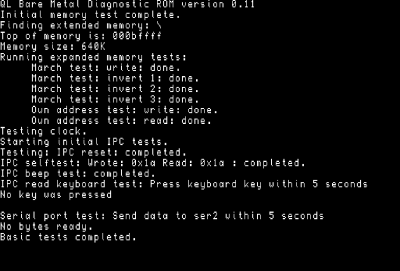

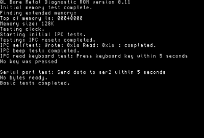

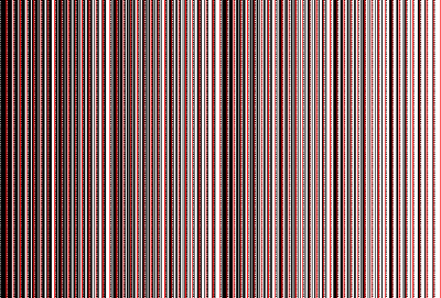

I padded the .bin file to 48k and tried it with Qemulator, just for fun.
It starts with a white screen, then black, then white again, then black. Then this pattern appears:
After that a black screen with text appears and tells you what it's testing and when finished it looks like this (in 128k configuration):
Or like this with 640k RAM:
