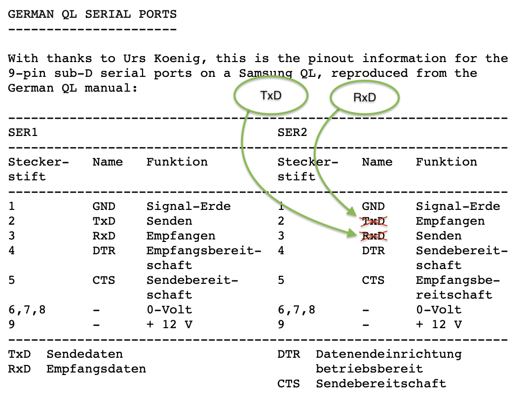

Hi everyone,
I'm trying to make a serial cable for a QL (with German-style serial connectors), to connect it to a Simple WiFi modem with a DB-9 plug (which should fully emulate a WiFi Hayes modem). After doing some research, I came across this wiring diagram:
I made a correction — please let me know if I got it wrong — regarding TxD and RxD on SER2, interpreting the German labels Sender and Empfangen as transmit and receive, respectively.
(Sender = transmitter, Empfangen = receive).
Otherwise, SER1 and SER2 would be nearly identical, which we know isn't the case.
Based on this, I built my serial cable (with two male DB-9 connectors) using the following pinout:
DB-9 Male (German QL)         DB-9 Male (Hayes Modem)
  pin 1   GND   		 →   pin 5
  pin 2   RxD  			 →   pin 3
  pin 3   TxD  			 →   pin 2
  pin 4   DTR  			 →   pin 6
  pin 5   CTS  			 →   pin 4
Unfortunately, it doesn’t work, not even when connected to SER1.
I also checked this page: https://dilwyn.theqlforum.com/gen/serial/serial.html
…but it wasn’t helpful in my case.
Does anyone have experience with this setup or suggestions?
Thanks in advance!

TxD and RxD are in fact on different pins on ser1_ and ser2_, just like CTS and DTR.
And some of the confusion has a lot to do with the fact that Sinclair (sometimes?) had the weird habit of labelling pins with "what needs to go in here" rather than "what comes out here"-like everyone else does, starting with the ZX81, whose tape output was labeled "MIC" and input labeled as "EAR"). And yes, it's confusing.
My (roughly 25-year-old) notes say:
 	SER1		SER2
1	GND		GND
2	TxD		RxD
3	RxD		TxD
4	DTR		CTS
5	CTS		DTR
6,7,8 	GND		GND
9	12V
And, if I remember right, my Diablo-630 (a monster daisywheel printer) was happy with that back then.
If your connected device doesn't use HW handshake, the DTR line on the QL end should not be left open, but be connected to +12V, otherwise the QL will never send anything.
(i.e. all pairs are swapped between ser1_ and ser2_)
Robbizz
Posts: 18
Joined: Mon May 29, 2023 11:23 pm
Re: Serial Cable DB-9 for German QL Ports
Post by Robbizz »
tofro wrote: Thu May 15, 2025 5:26 pm TxD and RxD are in fact on different pins on ser1_ and ser2_, just like CTS and DTR.
 	SER1		SER2
1	GND		GND
2	TxD		RxD
3	RxD		TxD
4	DTR		CTS
5	CTS		DTR
6,7,8 	GND		GND
9	12V
Ok, so for a minimal configuration I could follow your pinout by also connecting the 6,7.8 pin to the GND? If it doesn't work, then, I should try to connect pin 9 (12 V) to the DTR, did I understand correctly?

Posts: 3160
Robbizz wrote: Thu May 15, 2025 6:08 pm
 	SER1		SER2
1	GND		GND
2	TxD		RxD
3	RxD		TxD
4	DTR		CTS
5	CTS		DTR
6,7,8 	GND		GND
9	12V
6,7,8 is already connected to GND, no need to do that. Connecting 9 to DTR will handle the QL end of things (only). The "other" end might have its own requirements regarding handshake - This will need to be handled as well.
A full recommendation for a cable can only be made once we know this other end's requirements.
