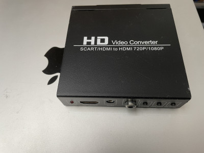

Once you have verified your QL is perfectly able to generate an RF signal, you can safely assume its video circuitry is completely OK (RF and composite are internally derived from the very same RGB signals that are on the RGB output). To make sure it stays that way, please follow Popopo's advice.
So, the problem seems to be either with your cabling between the QL and your HDMI converter or the converter itself. Can you provide a picture of what you use? Maybe someone can identify as "works" or doesn't work" on the QL. Properly working HDMI converters (not just for the QL) can be hard to find, and the ones that work might not necessarily cope easily with the QL's non-standard video signals.
The easiest step forward would be when you had something that wants a SCART input - QL-to-Scart cables are relatively easily obtainable and most TVs/monitors are able to display at least something from them.
I'm using three like in the attached picture (obtained years ago from eBay) and they work perfectly well for me. I have alsobuilt a QLVGA, which really is very good (if not better than commercial converters) considering the cost.
Or you go the QLVGA way as recommended above (and maybe find someone who is willing to build one for you, it is really easy, straighforward and likely the cheapest working way to achieve proper video on modern displays).
(There seems to be an offering on ebay UK that is close to my setup, and that I consider way overpriced. I think my converters that look the same were <20€ back in the day from China)
