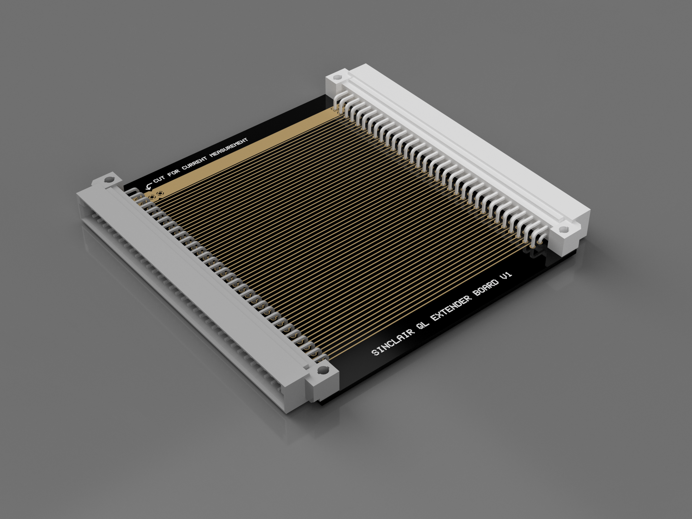

Ok, here's what I got for now. I think this could be useable for you as well?
There is a jumper on the board with a track underneath that can be cut. For current measurement purposes.
I will order a few boards.

Marcel_X wrote: Sun Apr 06, 2025 2:20 pm Ok, here's what I got for now. I think this could be useable for you as well?
Looks good! Anything that will save damage on the QL port is good for me

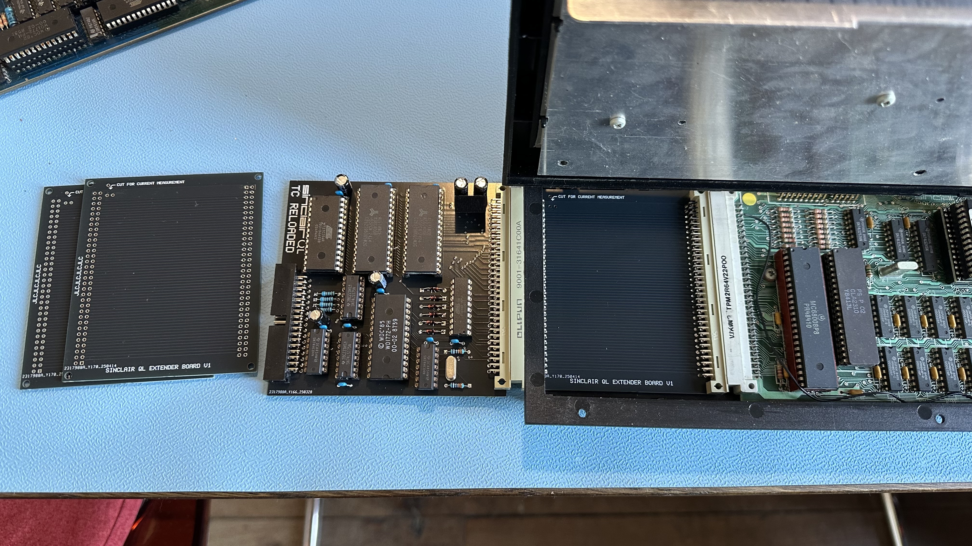

Hi t0nyt,
Just received the boards. Tested with my Trump card and it works fine! If you're still interested, drop me a PM.
I have a few more left, so if anyone else is interested, with or without connectors, let me know!
But you're correct. I ordered the wrong DIN 41612 initially. Those had 96 pins with only 64 of them actually installed.
And these won't fit! You have to search for the type Q version. RS-Online in the UK have them, but quite expensive!

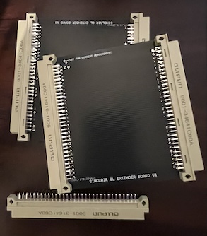

Just like to say a big thank you to Marcel_X for the package that arrived this morning
They work a treat
And thanks to all for the various advise
