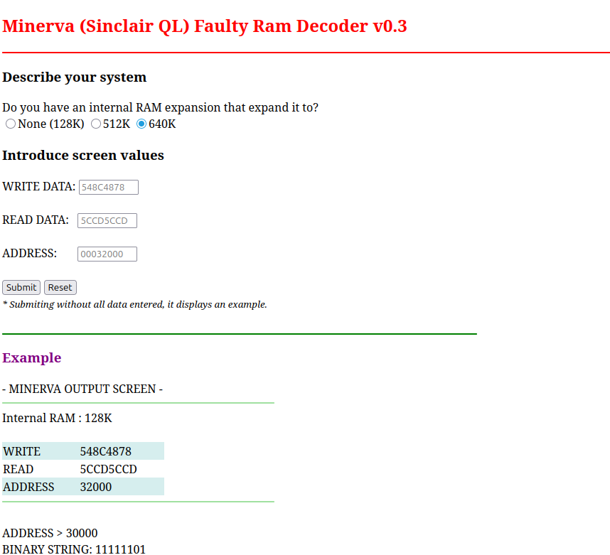

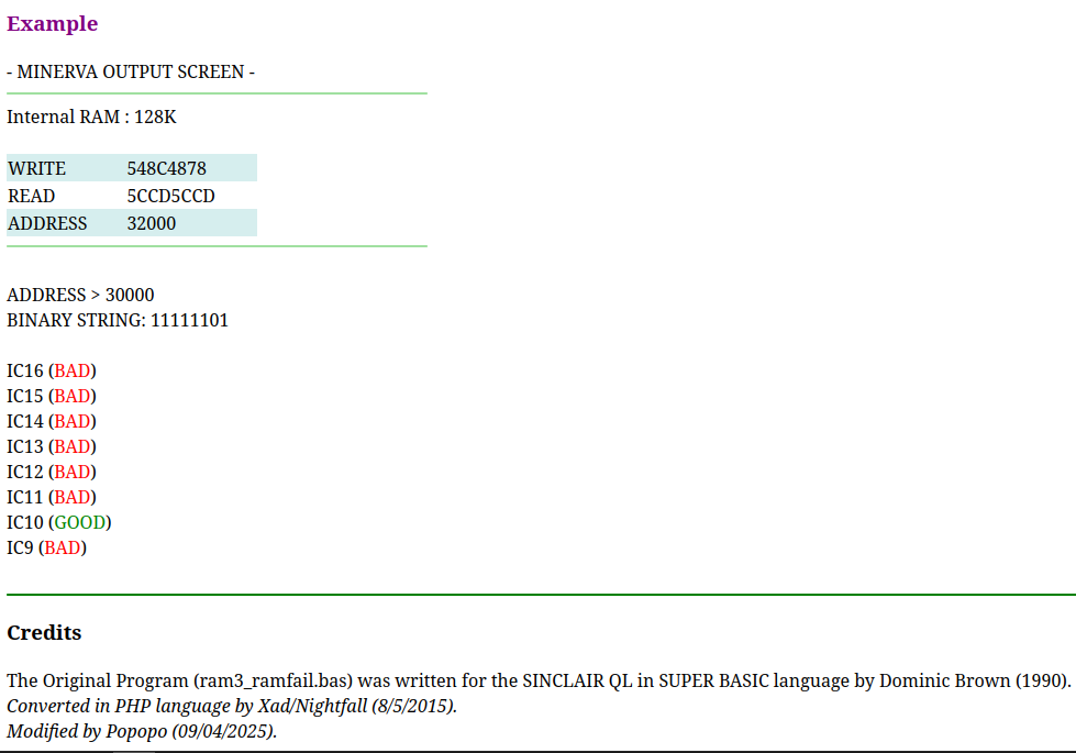

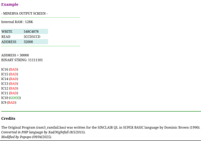

Hello everyone.
I have change the way that Faulty Ram Decoder works and take datas to decode and point to a failing RAM IC.
Update: 13/04/25 all info and code available on my repository. Now with a lot of documented historical information and the final code.
Purpose
I have made changes in the ram_fail php code in order that now, it may detect a faulty RAM IC in expanded (modded) Sinclair QL boards that are increased till 512KiB or 640KiB of RAM.
So from now on, it is not for only stock QLs with 128K.

More info and the code to download
Some demo images:
