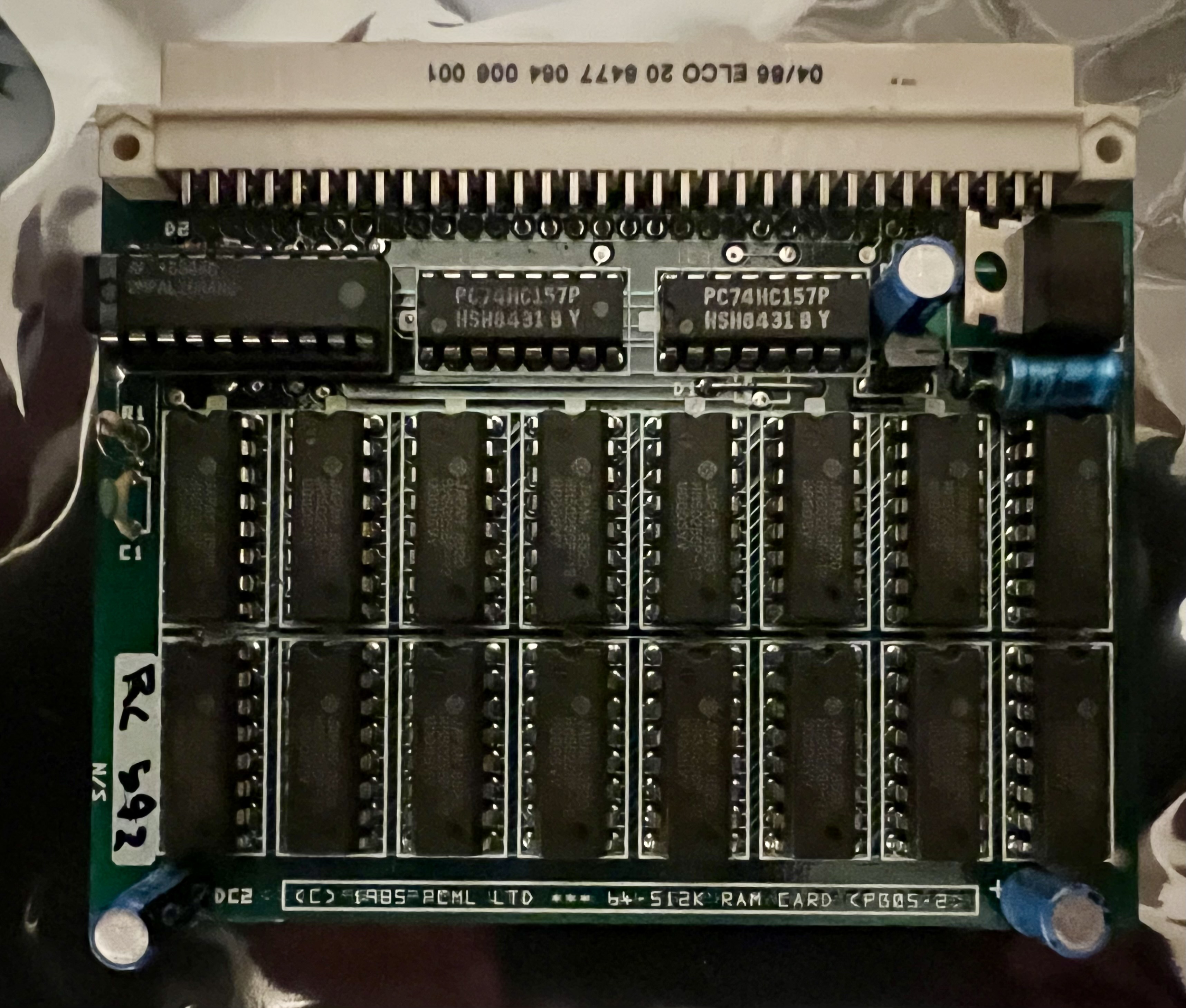

Totally off topic but I can’t find any pictures of the PCML RAM card online, is it rare?
Posts: 3196
Re: Memory IC's for PCML Q+?
t0nyt wrote: Thu Feb 20, 2025 8:35 pm Totally off topic but I can’t find any pictures of the PCML RAM card online, is it rare?
Wouldn't necessarily say it was rare. But relatively unpopular. It was one of the RAM expansion boards that didn't have a through-connector. So, if you wanted RAM and (the RAM needs to go in first because of the floppy connectors) keep the option open for floppy drives, you were at a dead end.

tofro wrote: Thu Feb 20, 2025 9:58 pm
Ironically it’s probably of more use today, than it was then, with storage devices like Qimsi for the ROM port
