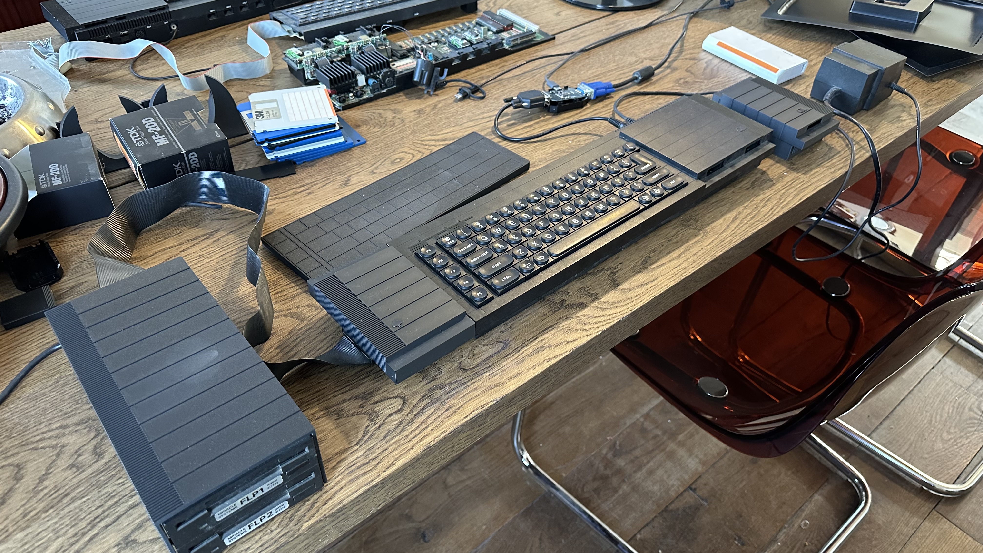

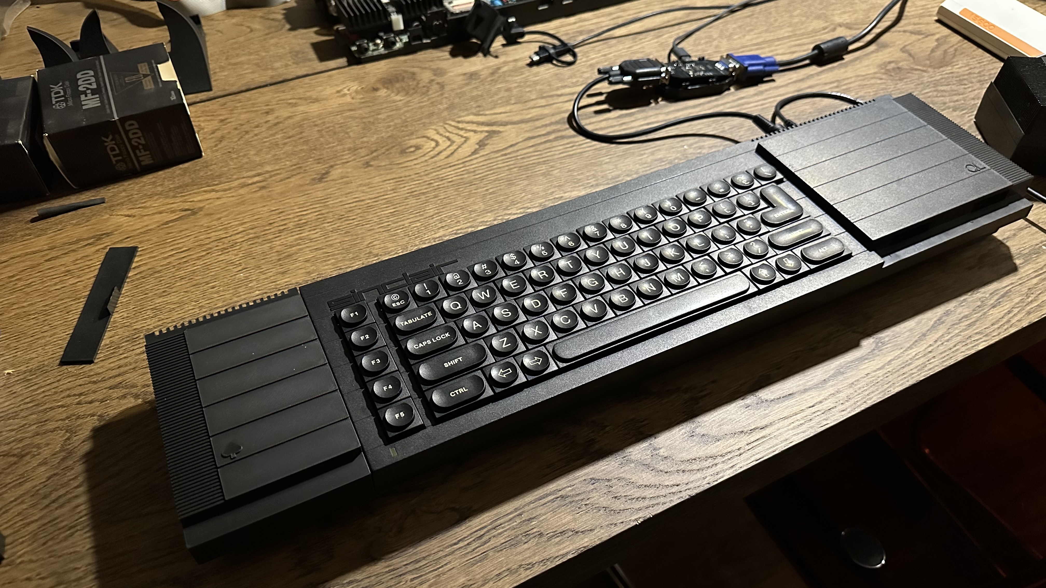

But because I never really liked the looks of the black metal heatsink, I thought I'd give it a makeover... So modelled up a cover and 3D printed it. It is just stuck on with double sided tape.
Next up is a cover for the dual floppy drive that I found in another box. It looks quite crusty after all these years. Especially all the screws that hold that thing together are rusty.

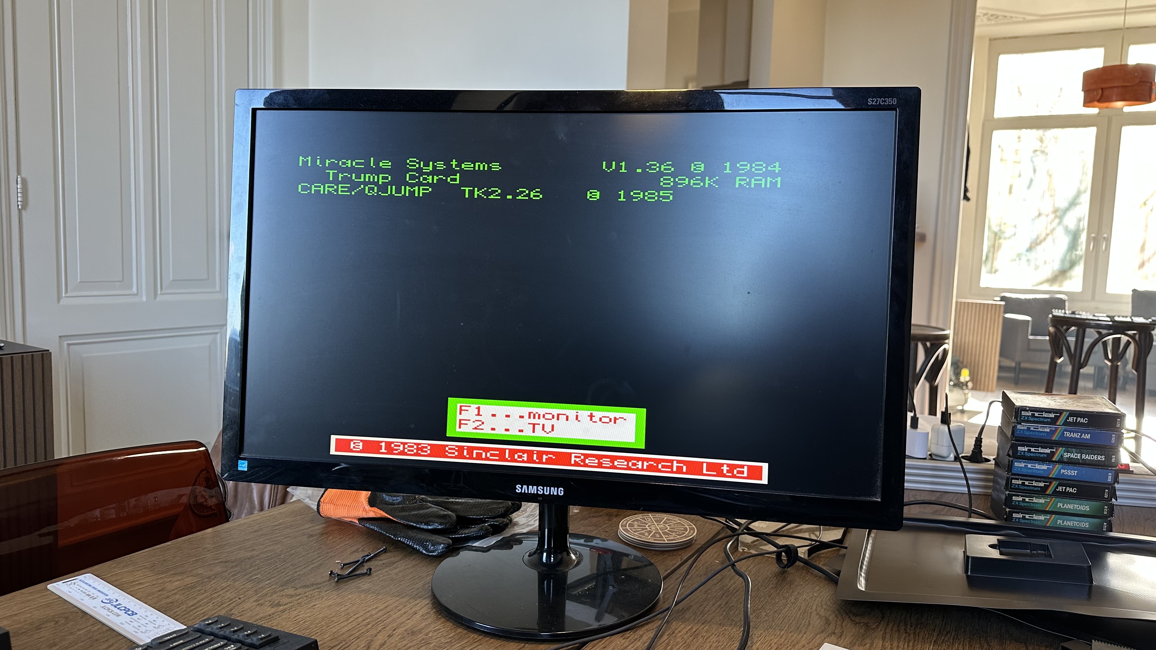

Much better.

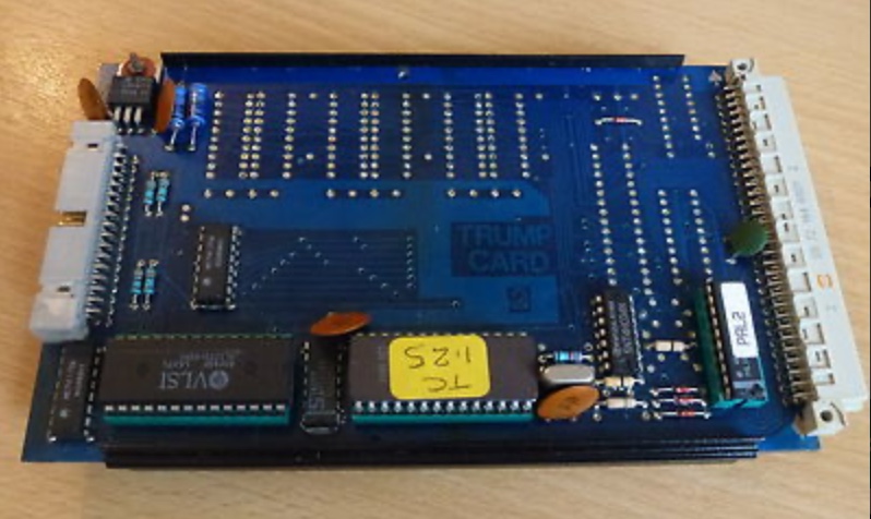

Had a quick search online and the two versions of the card only seem to differ in the type of memory used. Same number of PALs, the same logic ICs, same floppy controller. I can only see one 74F175 (quad flip-flop) added to the v2. But my best guess is that that one is used for memory decoding. v2 looks like a cost-down version of the v1.

That's another good theory! It would at least explain the quad flip-flop. I did find an image online of a TC2 with no memory and just PAL2 for the EPROM and WD1772. But it has the quad flip-flop soldered in!
But I just checked v1.36 and that one is working. I'll try 2.19 next.
