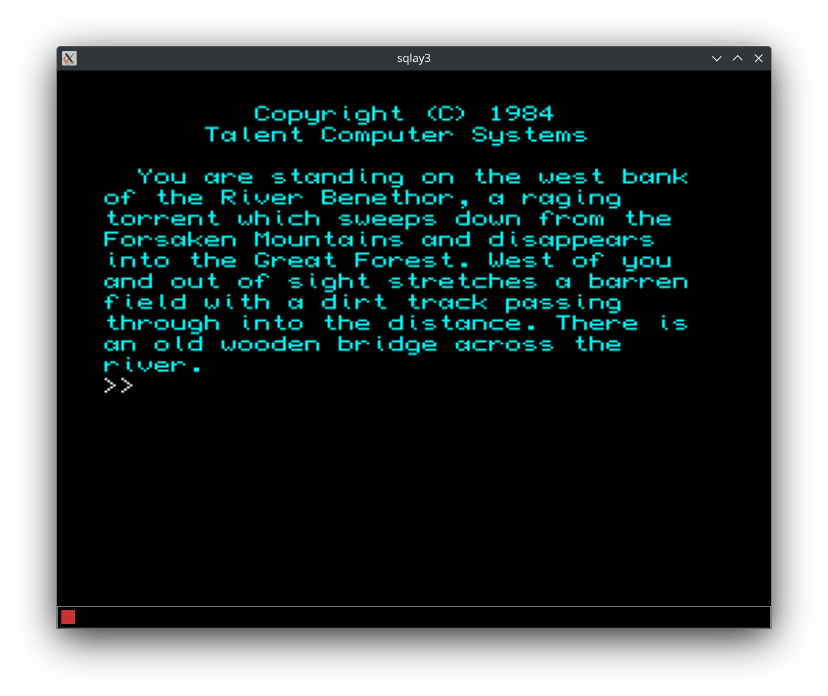

I would love that info to work out why sqlay3 cannot play a copy protected MDV!

It looks like after the Copyright scroller Zkul turns on all the MDVs at the same time!

So finding that it was being weird on the MDV select was the key, my "protected" image is now working.
So it does seem to be only based on the RAND!
Posts: 1208
Re: Stumped on a Cartridge Repair
With some PM discussions I’m having it does seem to be the case that it’s just a magic number and for some reason the magic number is getting changed when I try to image a cart

My problem with re-creating a protected West cartridge is now resolved
Many thanks to the forum member who gave me a crash course in magic numbers over PM
Also, many thanks to everyone else who has been helping
All greatly appreciated
The one thing that clinched it in the end was to remove vMap from my QL, no idea why
