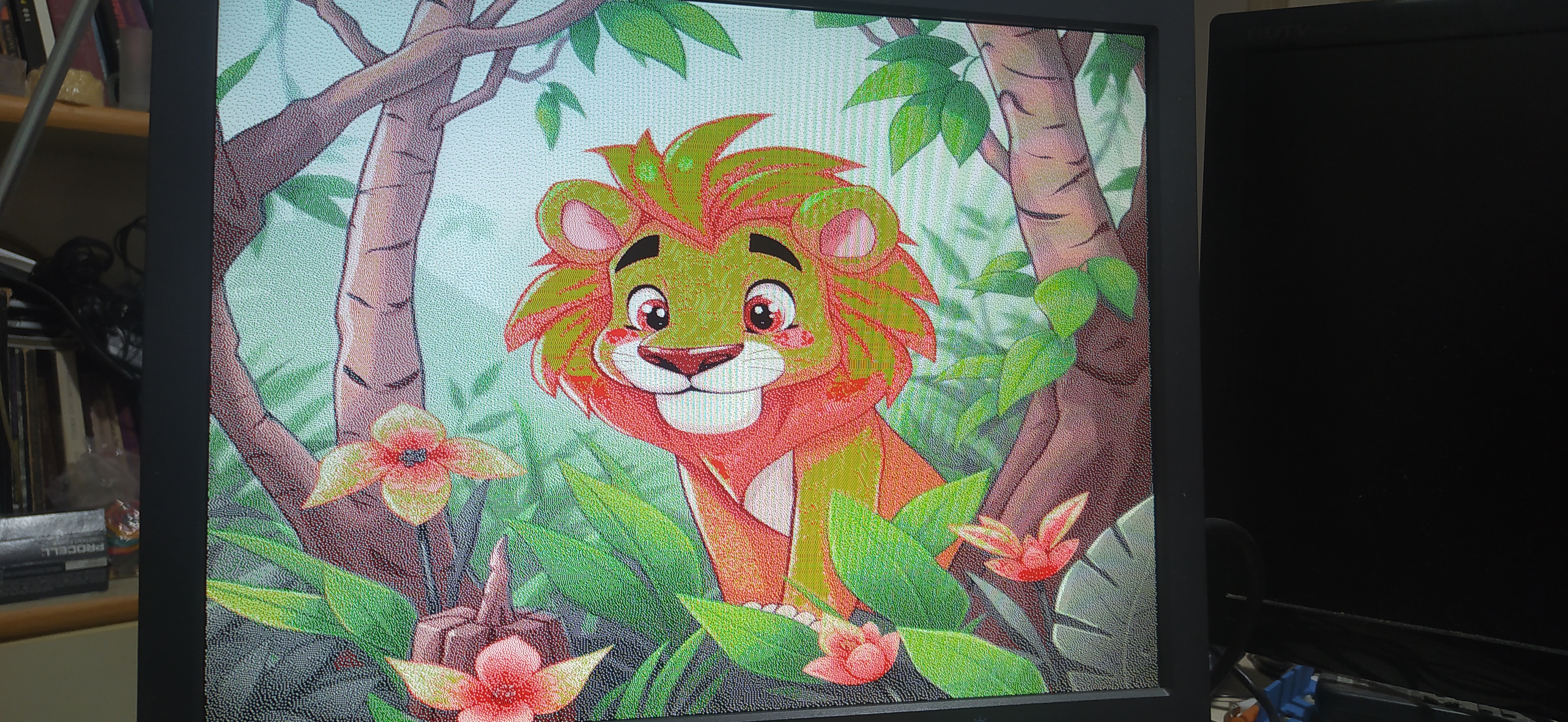

Thanks, and 1024x768 4 colors
Posts: 1590
Re: QLion Gold Card
Amazing that's only 4 colours!
Posts: 1056
Re: QLion Gold Card
lliont wrote: Mon Feb 03, 2025 1:46 am Thanks, and 1024x768 4 colors
It looks to me more like 8 colors. at least
lliont
Posts: 342
Location: Athens, Greece
Re: QLion Gold Card
Post by lliont »
Gimp did the dithering, I was impressed too
The palette seems the default one (red-green-black-white). I suppose it can't be changed, am I right?
lliont
Posts: 342
Re: QLion Gold Card
Post by lliont »
yes, I haven't done this for the 1024x768 mode but it's easy to add palette choice.
