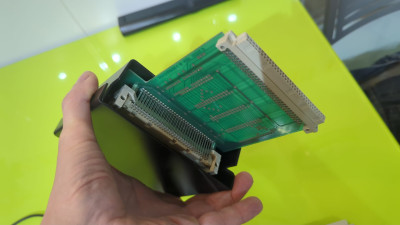

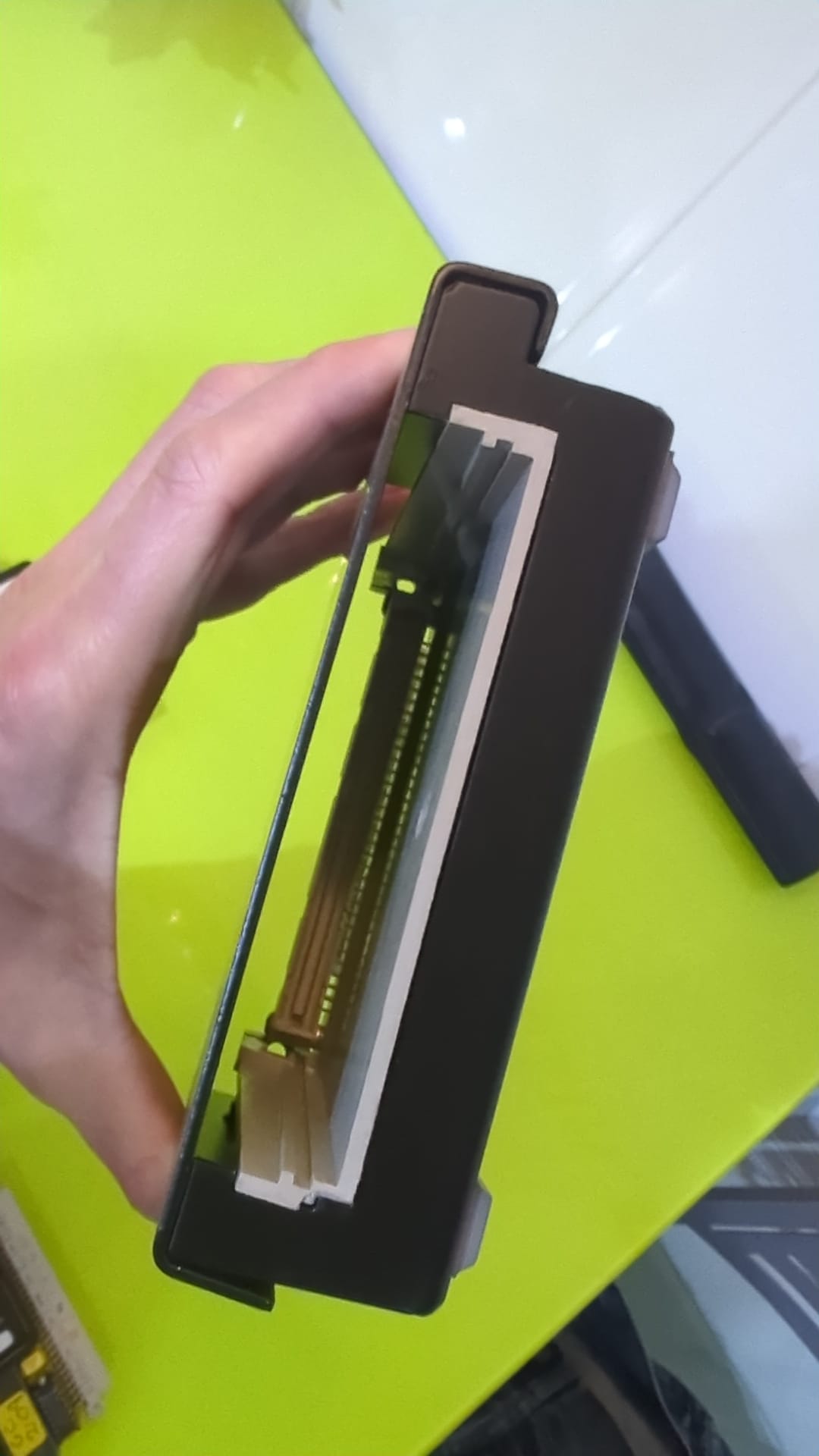

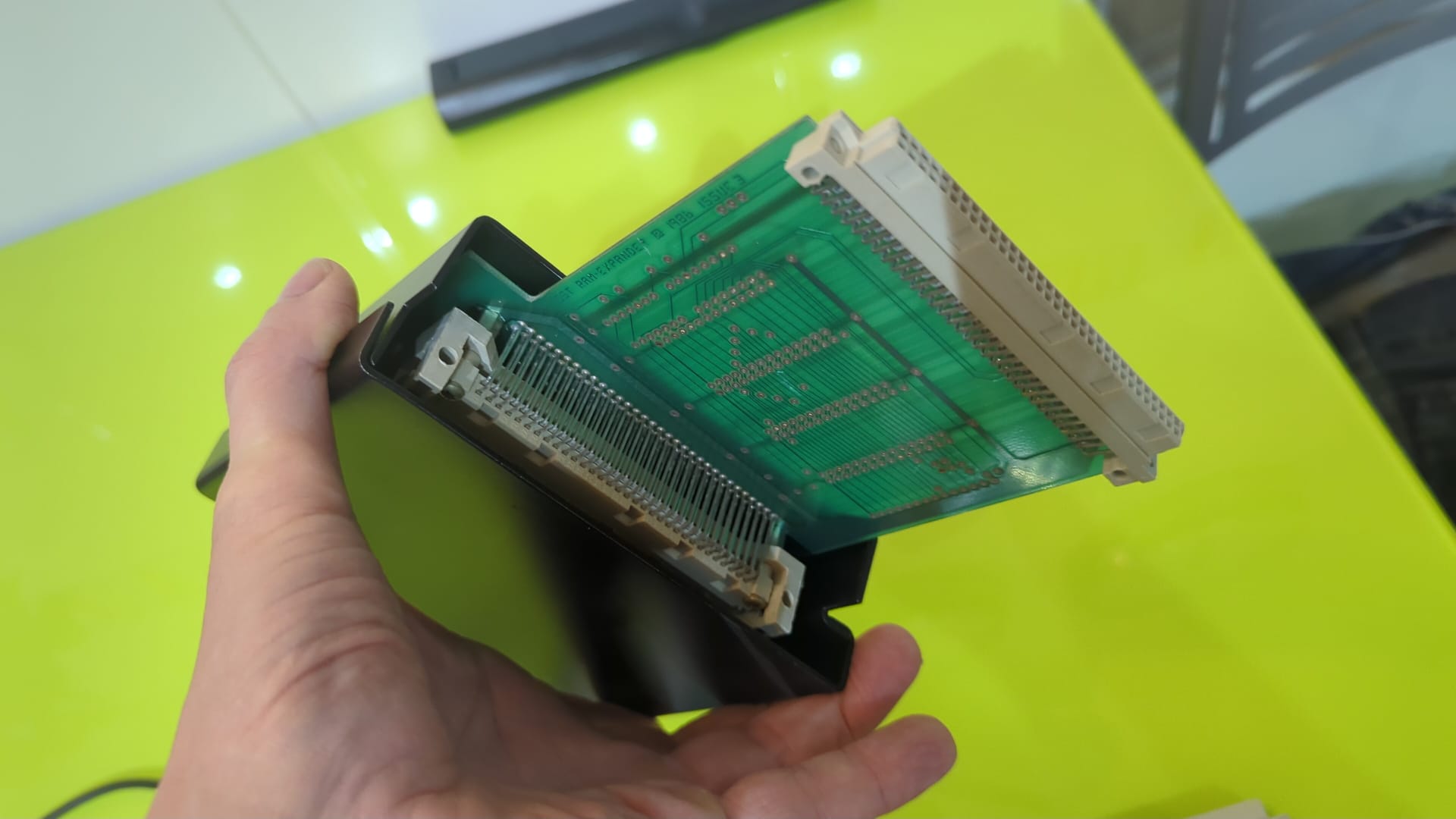

Can some one identify this expander board?
A friend sent me this pictures, but I'm not sure if is a memory expansion or the Q+2 that your talking, by the text on the board, the unpopulated ROMs in the pcb and the detail that the top board can't be easy removed.
Posts: 1582
Re: CST Expander and other updates
That's the CST unit - CST RAM Plus - it's a 512K memory expansion, plus 4 Eprom positions (upto 32K each I believe - sockets and additional components not usually fitted for these ROM positions) and an additional bay to take another expansion card.
