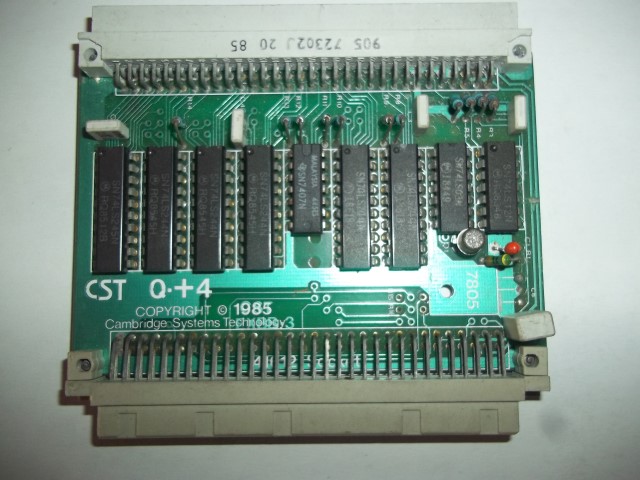

There is no doubt that the CST Q+4 expander existed, as a friend, had one attached to his QL. Alas, he is not with with us anymore and the I do not know what happened to the QL equipment.

Later, I got a CST Q+4. This could handle up to four plug-in cards, all of which could have onboard driver ROMs even on those early ROM versions - it had an onboard ROM which corrected the defect in pre-JS ROMs to allow them to find more than one such card. A short ribbon cable came from the base unit to its own circuit board which plugged into the QL expansion slot. The Q+4 was a big, heavy beast. Black metal-cased, it sat under the QL and needed its own power supply, which superficially looked like a QL power supply (it probably was a QL power supply, the connector looks similar in the picture below, I sold the Q+4 many years ago). No doubt CST produced it because they sold a range of expansion cards for QL - Floppy disc, Winchester drive, SCSI and Q-Pi parallel printer interface, RAM cards, RAM Plus, for example.

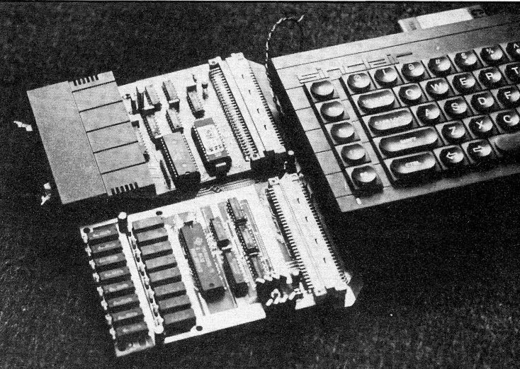

Re the last board: that's very interesting , but to my untrained eye am i seeing ram on the board and only one bus above it, as though it's an early version of the Ramplus?
It seems to have the positions for the 4 rom slots it would have on the board that goes in the QL.
I'll happily admit if am wrong.

Re: CST Expander?
I can see the word expander, possibly CST before it, 1985 and issue _ Dilwyn.
Edit. Just checked the QL Wiki for the Ramplus and it looks the same. It has expander written on the pcb.
Does anyone have a pic of the Miracle Systems double expander?

I assumed it was a 2 slot expander because its filename in my collection of photos was "cst_2slot_expander", wherever I got that name from at the time. Unless I just saw the word Expander on the PCB and assumed.
Yes, in the QL WIki picture by chr$ I can see the words "CST RAM+ Expander" on the PCB.
Ah well, another good idea bites the dust.

Yes, some of the Ramplus photos on the Wiki page are titled that and some as ram expander, possibly because of what is etched on the board.
That, and with the Computermate advert mentioning Q+2 and Q+4, someone has assumed they are both CST I think.
