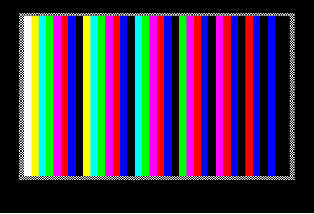

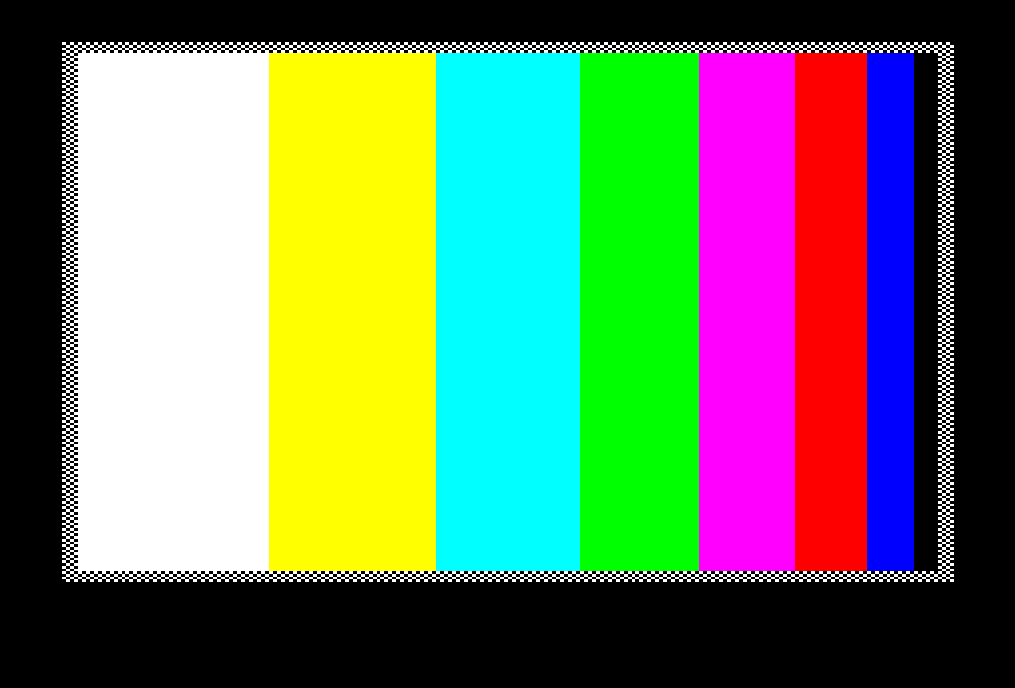

Ok, that didn't quite work. I'd have to think about a better way of doing this. The color test isn't quite in the order I wanted. I just went white to black twice but that gives repeating patters instead of a gradient. Here's the simple BASIC program:
5 REMark Dithvide lores color palette
10 k = 0: BORDER #1,4,255
15 FOR i=7 TO 0 STEP -1
20   FOR j=0 TO i
25      BLOCK #1,12,192,k,0,i
30      k = k + 12
35   NEXT j
40 NEXT i
45 SBYTES mdv1_loColorTest1_scr,131072,32768
50 k = 0: CLS #1
55 FOR i=7 TO 0 STEP -1
60   FOR j=i TO 0 STEP -1
65     BLOCK #1,12,192,k,0,j
70      k = k + 12
75   NEXT j
80 NEXT i
85 SBYTES mdv1_loColorTest2_scr,131072,32768
90 BORDER #1,0,0
Here are the two source images:

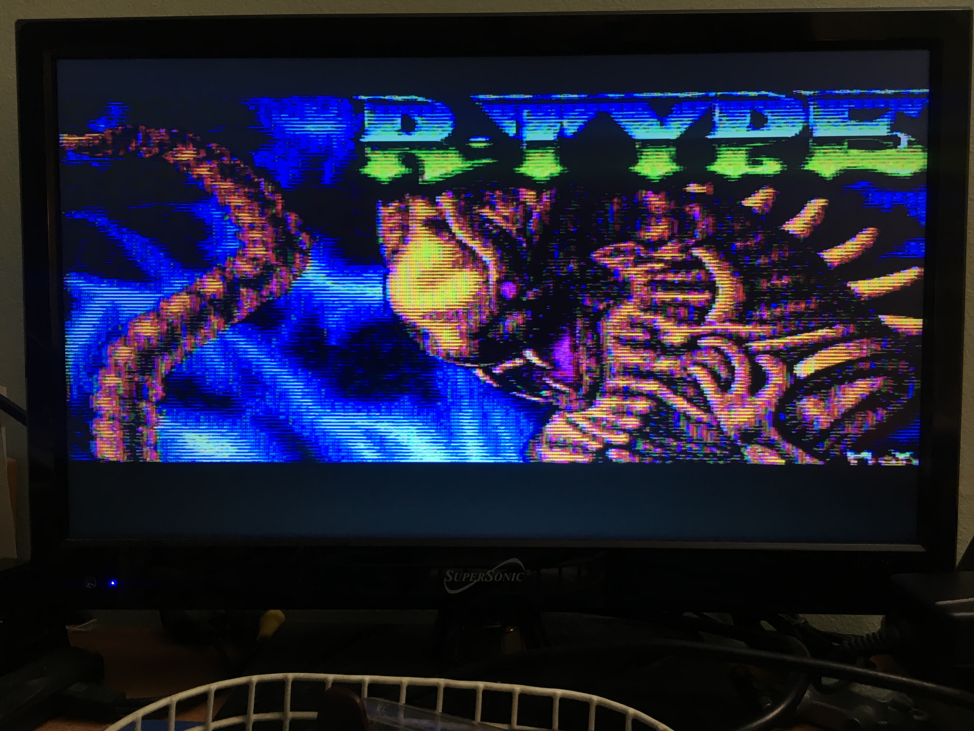

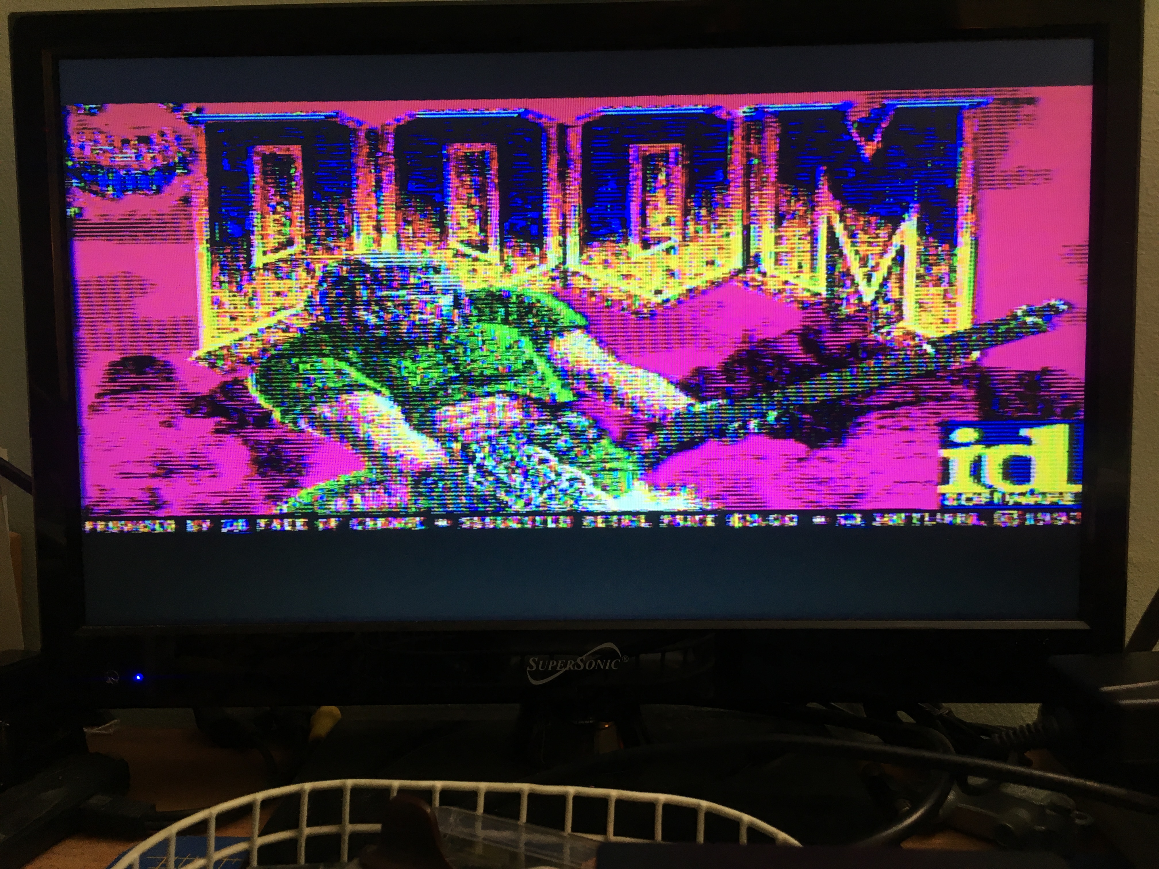

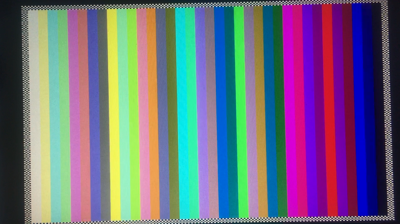

Ok, finally got to try it on my 128K QL and it worked (reminder that I have an NTSC machine). Here are the two mixed-mode pictures. The image was solid, couldn't tell it was swapping images quickly. Note that this is a composite output hooked through a cheap upscaler (mini av2vga), so there is lots of interference (plus, my LCD tv/monitor makes red look more pinkish). I do have a SCART tv which gives a perfect picture and I'll try that next time.
Everything worked as expected, except for my own creation, the lores color test screen. On my QL it behaved the same as on Q-emuLator, constantly flashing. I'm not quite sure why that would be the case. You have two mode 8 images and all I'd expect is a solid picture of 36 color bars. So why do the bars flash?
Here are the 6 MDV files that I used (well, 5 of them at least, since one is just the source code of Dithvide). I've modified it so that if you add them all as a collection in vDrive, you just run the boot program from one of the 5 and it'll ask you for a new device each time and you can then just go through each of the 5 images to see what they look like (i.e. the boot program only sets aside memory at the start and then loops asking for device and calling the machine code).

The one question I have is why my own creation of the color test image flashed? I was in lores mode using two mode 8 images, where I was trying to get all 36 distinct color combinations, and the image was flashing on my QL. It's not mixed mode, so the timing values shouldn't be at issue. Unfortunately emulators can't replicate most of it, but if you try the lores one on Q-emuLator, which comes closest to working in lores, you can kind of see what I mean (i.e. COLORl.MDV).
