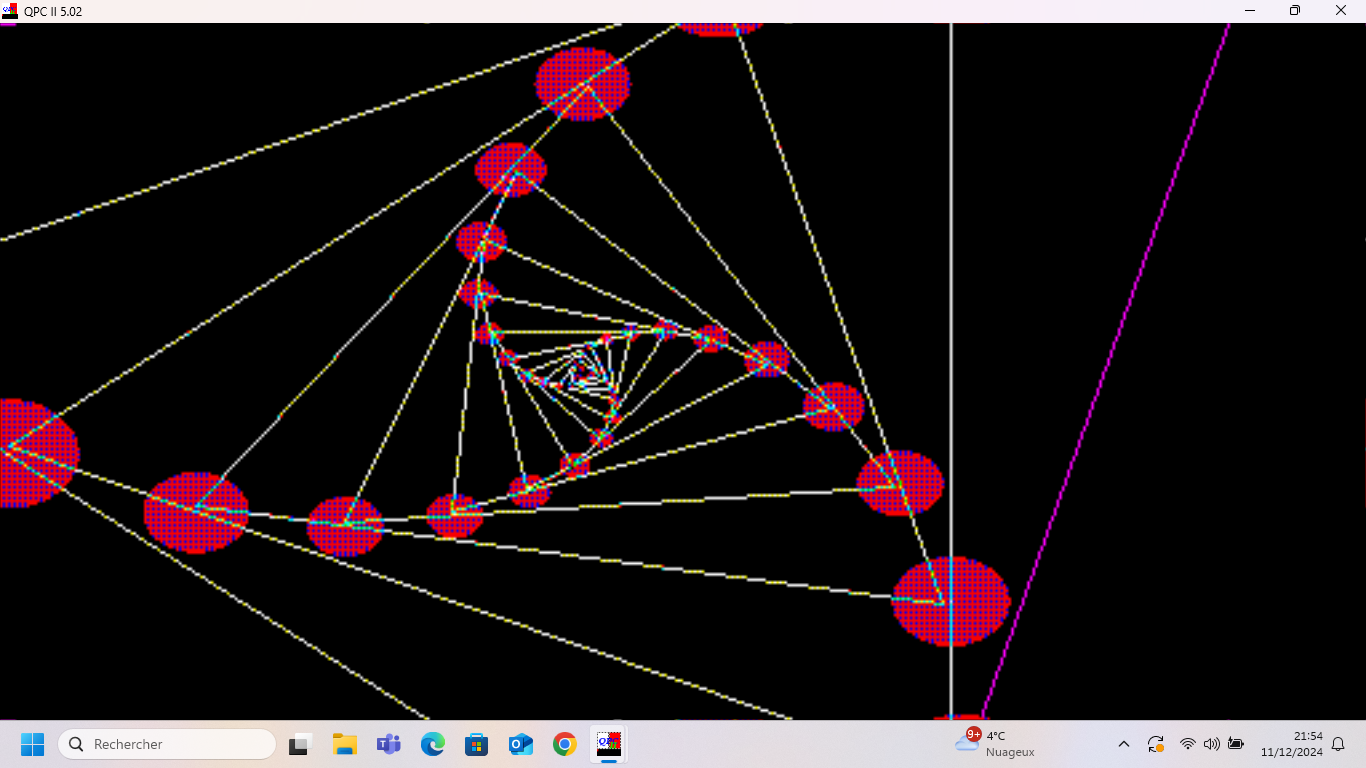

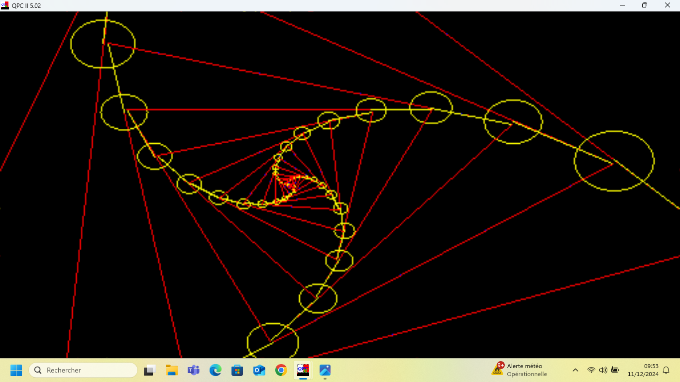

Hi All,
Thanks for your helpful suggestions. As a result, I have modified the previous versions.
Now it has been tested on : QPC2, SGC_qdos, SGC_smsq/e, Qemulator, JS and Minerva 1.97 roms, 128ko QL, both interpreted and compiled in mode 8.
The original 'popit' version had 4 Ko of code, but needed 25ko of dataspace in all.
By using a rotating array, I have reduced the dataspace to 5 KO, some 20 times less, for more animation !
The code is also renamed for clarity, with remarks added. Let SB=0 to turn sound off....
This will be my final version, which should replace both firefly_bas and popit_bas.
If you are looking for a new screen saver, try this : It is a firefly flitting around an animated screen popping bubbles.
Steve.
Steve.
