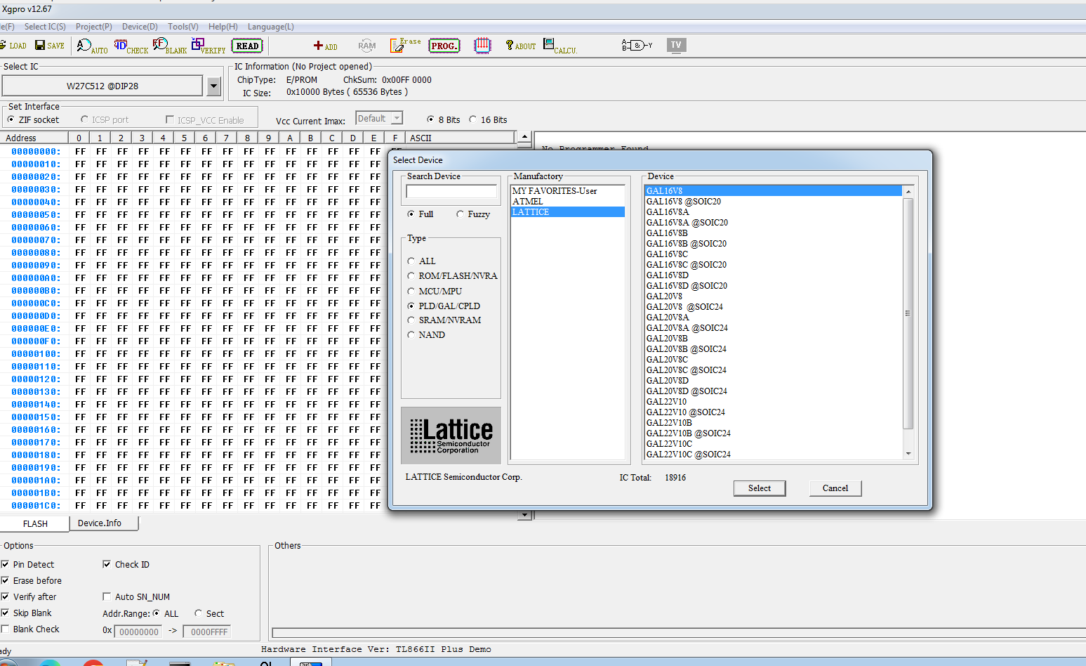

The TL866 II plus programmer,
seems that can program some PALs/GALs.
At least ATMEL and LATTICE.
Re: convert pal to gal file ( PaltoGal.exe )
it won't do Pal's unfortunately .
i have the T48 , and no pal's show up in the device list ( 12.67)
Have you have the last XGecu version software?techy wrote: Mon Dec 02, 2024 3:31 pm it won't do Pal's unfortunately .
I have not T48, but usually I go directly to the IC searching tool to check out if it is supported or not.
