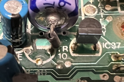

On the issue 6 board - this is to the left of and down a bit from the loudspeaker connectors - which are under the large heatsink (when viewing from the front of the machine)
https://www.sinclairql.net/srv/QLPCBoardIssue6.gif

Just so I'm 100% sure what I'm doing, it's the IC37 (by leg of large capacitor) that I'm replacing with a 78L12, +12v 100mA regulator please?

Is TR10 missing by purpose?
Posts: 1201
Re: More Serial Woes
Maskenlos wrote: Sun Oct 13, 2024 9:19 am Is TR10 missing by purpose?
Don’t know. This isn’t a picture of the actual QL I’m trying to fix, it’s my spare parts board which had a memory problem I couldn’t find a fix for. I didn’t remove TR10 from it though.
That's an early issue 5 - as you still have the battery contact points (not ever properly implemented)
But yes - that's the 12V regulator :-)
