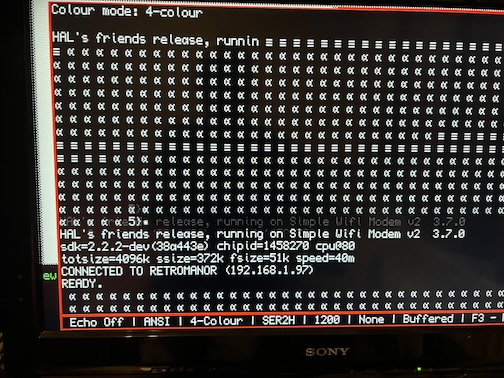

I tried another vRetro PSU on my main QL (as the original vRetro PSU had issues powering the QL with any extras attached) and now my serial communications with my RetroModem keeps giving me garbage on the screen as per the attached image. Switching back to an original PSU doesn't fix the issue suggesting something is now damaged in the QL?
I switched in a spare QL, using an original QL PSU, and the RetroModem works fine with that
As you can see from the image it's talking to the RetroModem at the correct baud as messages it generates are perfectly readable, but I can't do anything with it as the garbage characters are being constantly written to the screen
Anyone have any ideas what might be wrong please? Not sure if I've damaged the Hermes or another chip or something?

Was going to swap the ZX8302 but this QL has the resistor/fly-lead mod
I think I’ll break it for spares and move the Schon/Hermes/working MDVs etc to a spare QL

Whatever the cause of my Serial problems actually was, I accept it was likely a co-incidence and apologise for any offence caused
The serial issue is not something I've been able to resolve (have tried replacing 8049, ZX8302 & MC1488, thanks for the help Pr0f) so if anyone has any thoughts what else I could try it would be much appreciated please
