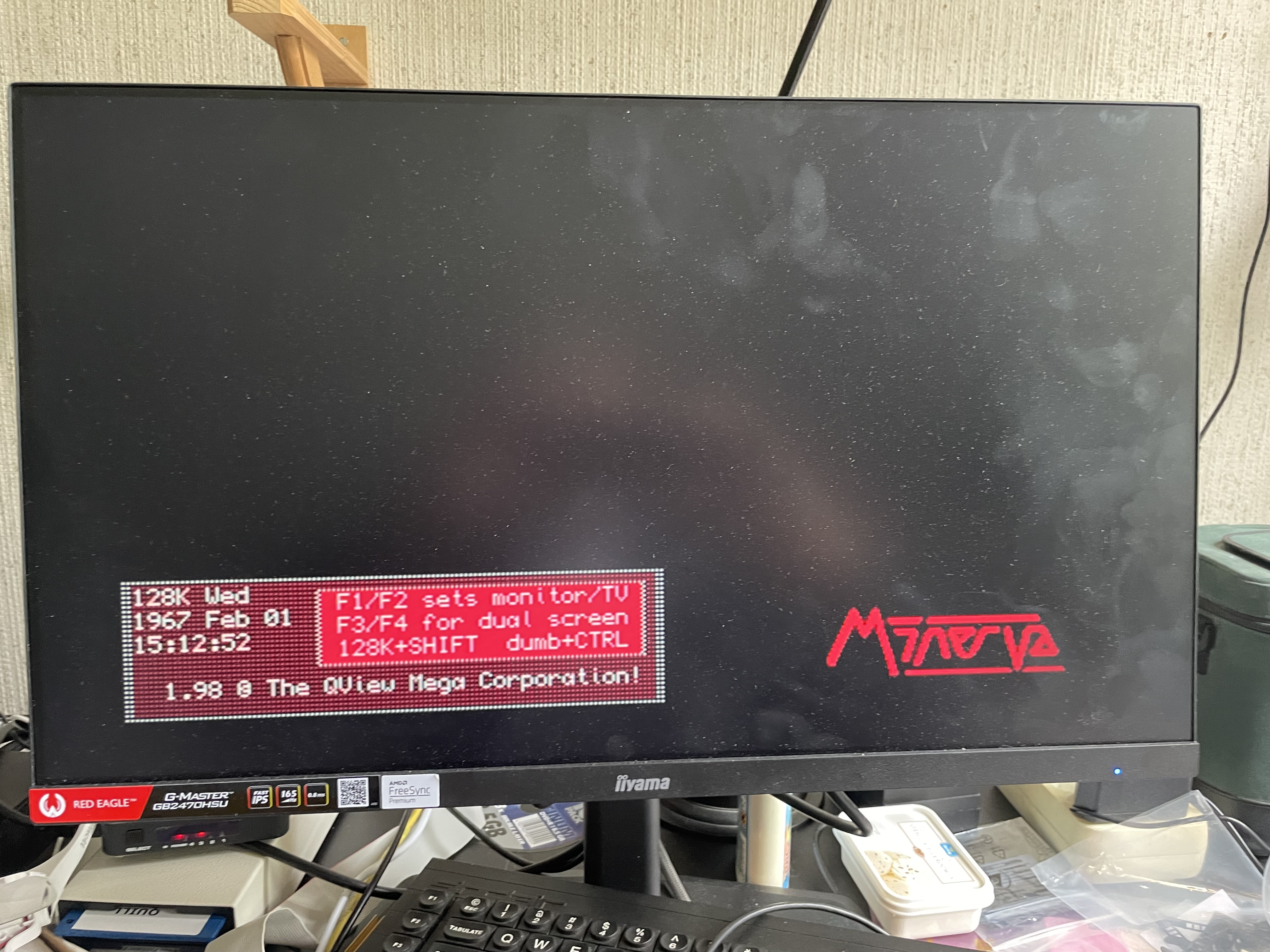

Interesting development, Fred
As for the placement of the two original ROMs, actually it doesn't matter at all which of the two sockets they are fitted in to as both have exactly the same pinout. The Masked ROMs take this in their stride due to the way the Chip select logic is enabled in each ROM.
Of all the start-up problems I've seen, I've never yet seen missing text in those small windows - until now!
The fact that cleaning the legs and reseating made some difference suggest to me more of a mechanical root cause such as poor contacts/damaged DIL socket or solder connections.
Do you get a different result if you do swap the two JM ROMs between the two sockets? If the sockets/contacts are at fault, I'd expect to see a -different- error when they are swapped.
Did you happen to try the Minerva board in both sockets? (Again, it will work in either socket under 'normal' circumstances.)

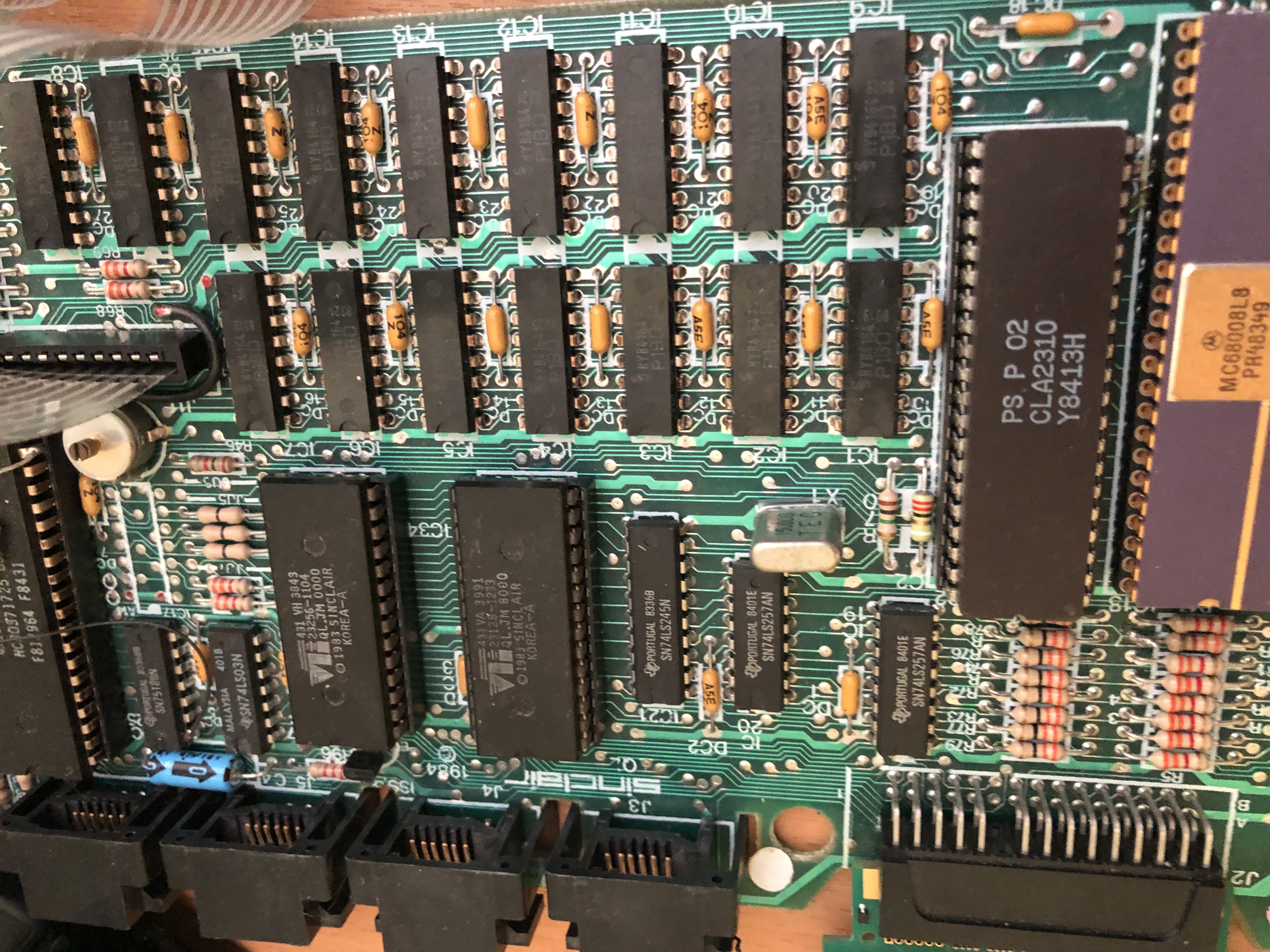

- Posts: 4850
Re: Problem after installing minerva
The Minerva ROM will work in any of the ROM Sockets. I usually have Minerva & QLSD in Socket IC34, nearest the 8302, to reduce the cable length of the QLSD Card reader, But Minerva can work in Socket IC33.
Pin 1 is the back left back side of IC33, IC34
The JS, JM, AH ROMs require a specific socket:
IC33 : JS-0000 9256
IC34 : JS-8000 9128
Have you tried cleaning the legs of the QL ROMs and Minerva.
IC33 : JS-0000 9256
IC34 : JS-8000 9128
- Posts: 1000
You might also want to try removing and re-fitting the 68008, ZX3801, ZX8302, and the 8049.
The sockets are not very good, and the IC legs can get tarnished. And they tend to 'creep' out of the sockets over time.
When you first removed the ROM's you might have flexed the PCB enough to disturb one of the other chips.

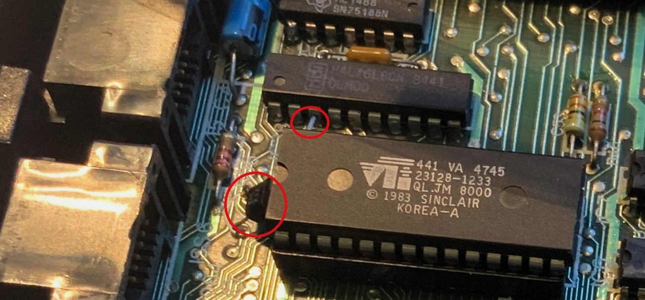

Is this a bented pin27? And in front of rom ic, i see the ZTX transistor pushed down.

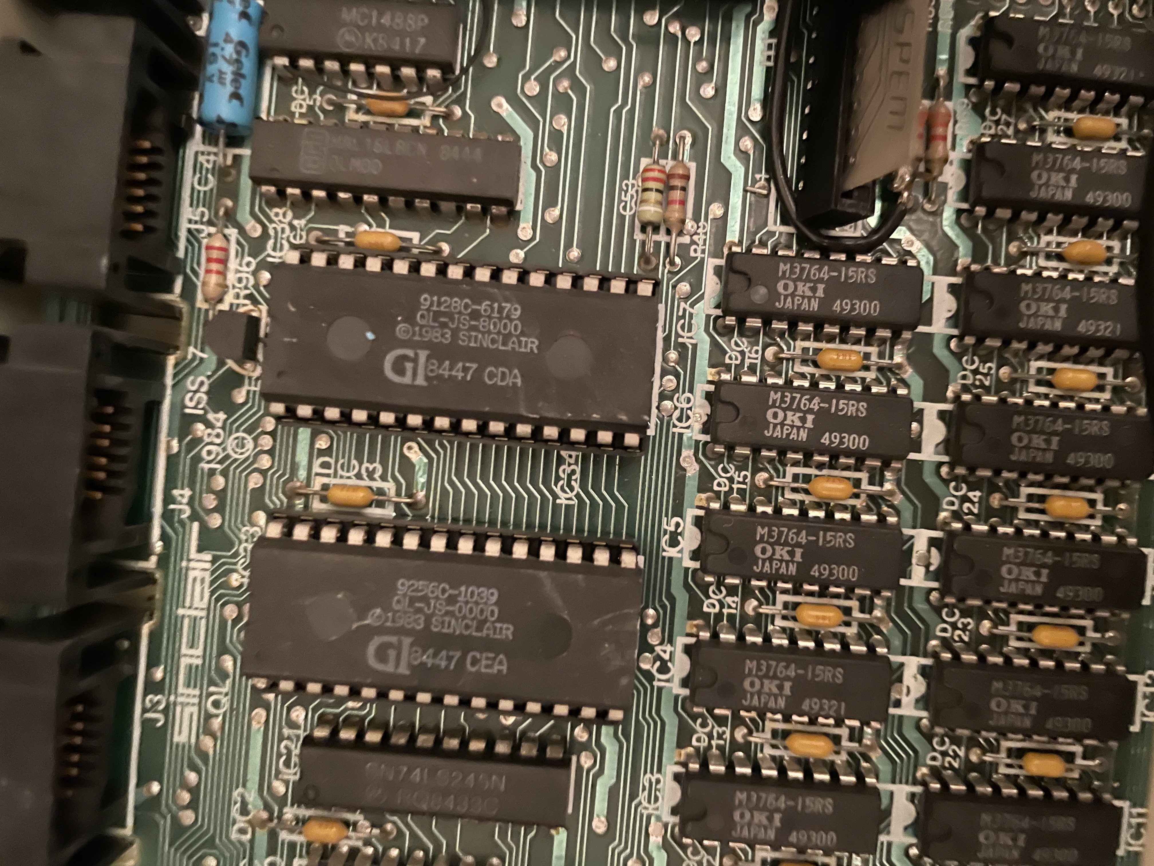

I got it working, I got a TDI with Minerva and used that as it should block the ROMs and use the Minerva on the board but this didn’t help so I toke the roms out and then is started working and it started up the normal way,
I put the Minerva rom in the position on the left of the 2 rom sockets and the problem was back and putting it and other Rom socket and keeping the left socket empty everything worked ok again.
