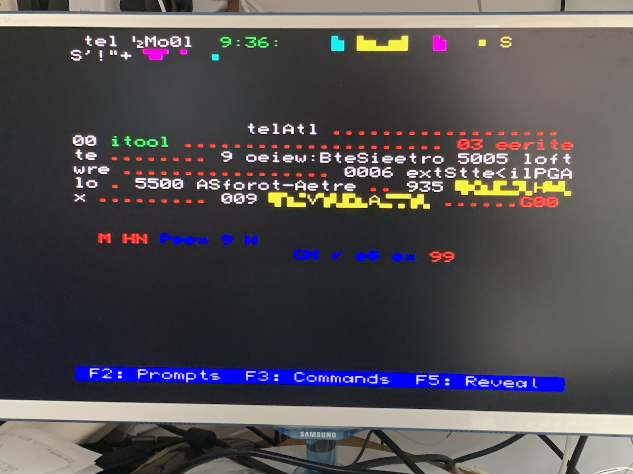

stephen_usher wrote: Sun Jun 30, 2024 7:33 pm @janbredenbeek is there a way to change the baud rate your terminal uses? I'm wondering if even the Hermes is failing to keep up. I'd like to drop the rate down to at least 2400 baud.
Just use the S*BASIC BAUD command to set the baud rate. QVIEW doesn't set it by itself.
It looks like you're losing characters due to a missing handshake. You should either connect the DTR line from SER2 to RTS from the modem, or lower the speed.
(QVIEW should work OK without handshake at 2400 baud, probably also higher, but 19200 will overflow the Hermes receive buffer without handshake).

Well, took the baud rate down to 1200 and no change.
P.S. Connected using my terminal emulator (VT52) at the same speed and although it couldn't interpret the data correctly for the screen display all the text was correct.

Hardware flow control: Check
1200 Baud connection: Check
Data OK on VT52 emulator: Check
QView able to show ATI6 data from modem: Check
QView able to decode pages: Fail.

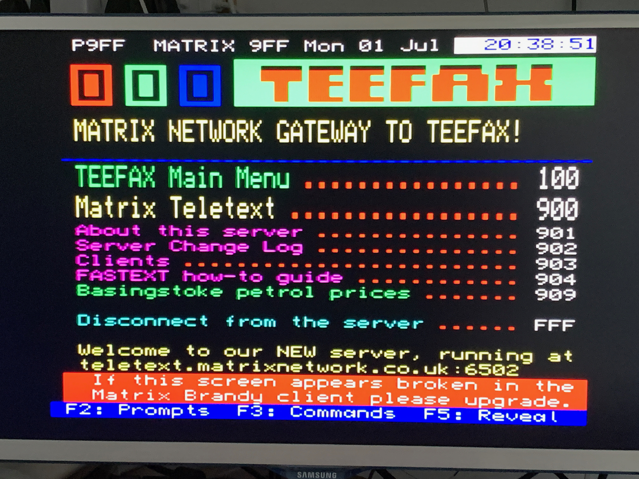

This is the NxTel landing page:
Without the source code to see what's happening I've hit the buffers.

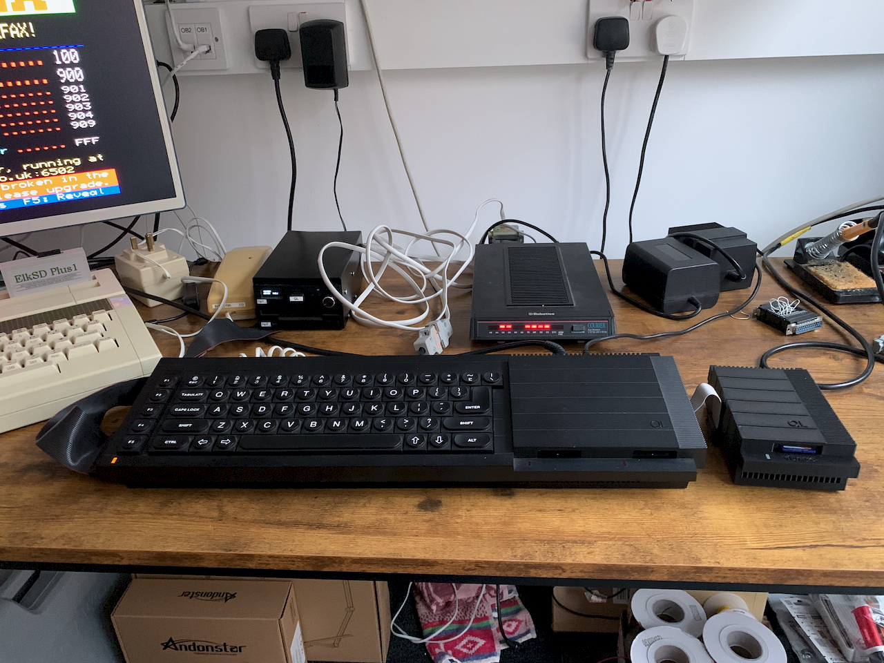

Hardware: BBQL (with Hermes and JS ROM) + Super Gold Card + US Robotics Courier v.Everything

Got it... Had to use the ser2e device as the feed is 7 bit even parity, one stop bit.
