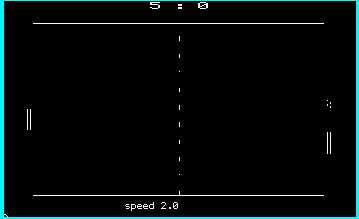

Picture 1. Sometimes I get a "double bat" (or is a bat called a paddle in a pong game?) on the left hand side.

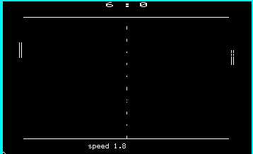

Picture 2. Sometimes the ball goes through the bat on the right hand side and leaves gaps in it. Hope the screen dump is detailed enough to show the missing pixels in the bat.

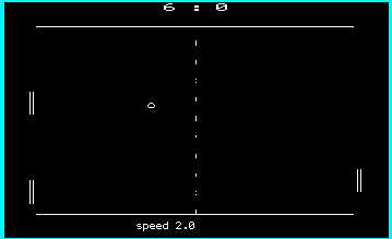

Picture 3. Sometimes you get some dots from the ball left on the right hand side when you miss the ball.

1. I saw the double bats also grinns the over-1 and over 0 and the old positions still need more ork.
2. I noticed the ball going through the bat also the position off the baal against the player must be improved.

3. Yey it happens same over-11 and over again.
