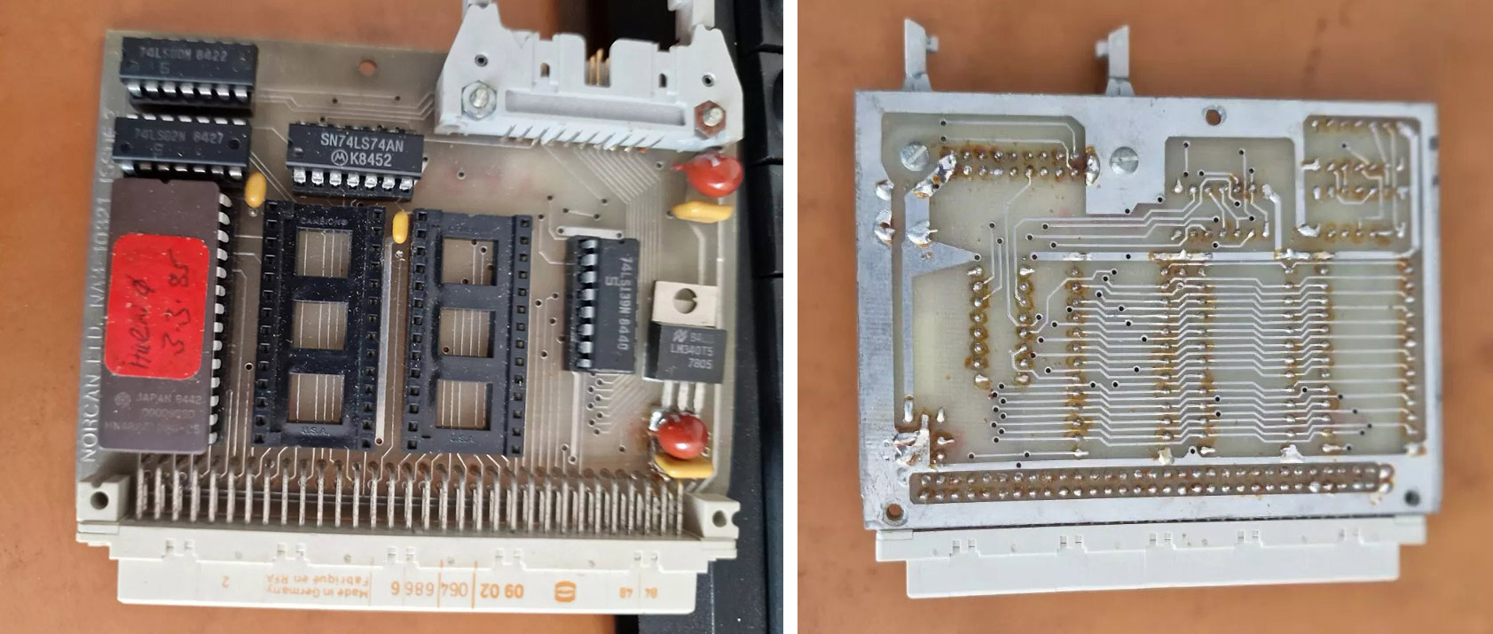

I presume this is some custom industrial expansion board - Does anyone knows what this might be?

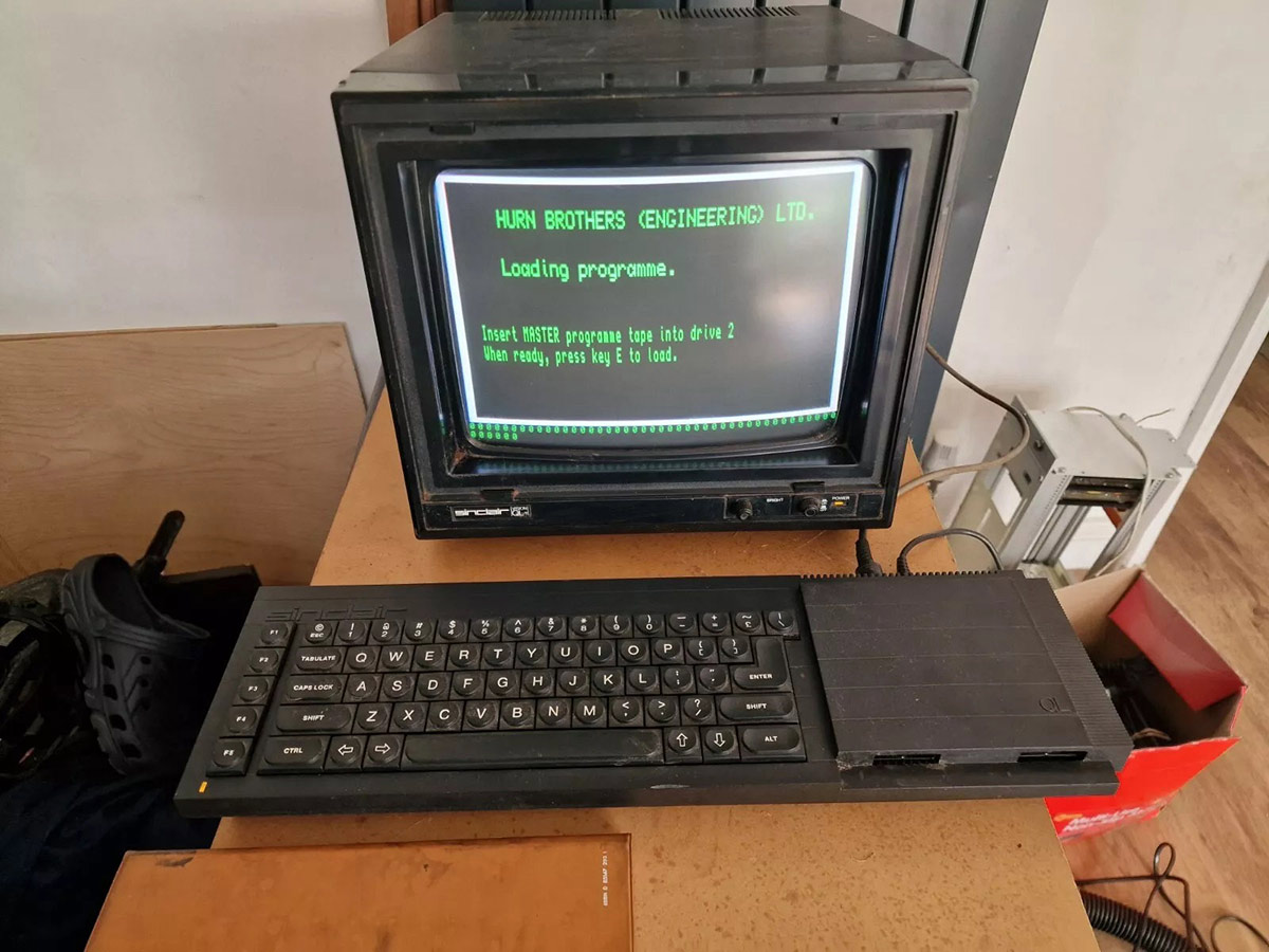

The screen shot says it's an engineering company.
Could it be a IEEE interface for driving things like milling machines.
Re: QL with a very unusual expansion board
I asked my son, as he works with modern engineering machining systems. Not being a QLer, he couldn't identify it specifically, but agrees with comments made about what it might be. He says that there is still a company called Hurn Brothers (engineering) Ltd in Dereham, Norfolk UK, although that might be a coincidence of names.
CST made a SCSI interface for QL back in the 1980s, though this doesn't look like the pictures I've seen of those.
A SCSI interface would commonly have a 50 pin connector.

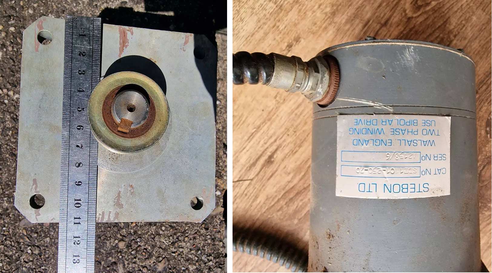

Probably servo motor control as steppers were not so prevalent back then when CNC were coming in.Andrew wrote: Mon Jun 24, 2024 9:54 amI presume this is some custom industrial expansion board - Does anyone knows what this might be?
https://united-kingdom.exportersindia.com/stebon-ltd/
https://www.daxautomation.co.uk/part/pa ... d40/338615

I think the question is mainly about the QL expansion board.
Without the two obviously missing chips, what remains is the EPROM and a bit of address decoding, and it's nearly impossible to tell what might have been in the two empty sockets. But they somehow yell "UART" at me. In the mid-1980s, serial comms was ubiquitous in controlling machinery. From the pin count, the missing chips could very well be Intel 8251 UART chips.
