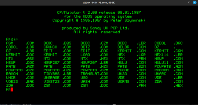

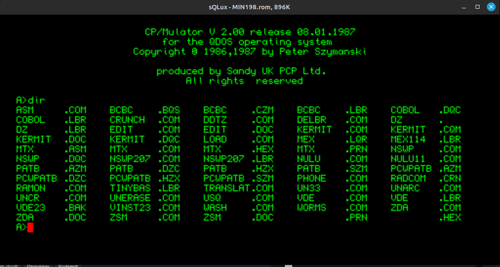

Here is a screen shot of CPMulator v2.00 running in sQLux
I will establish status and upload it here if I can.
