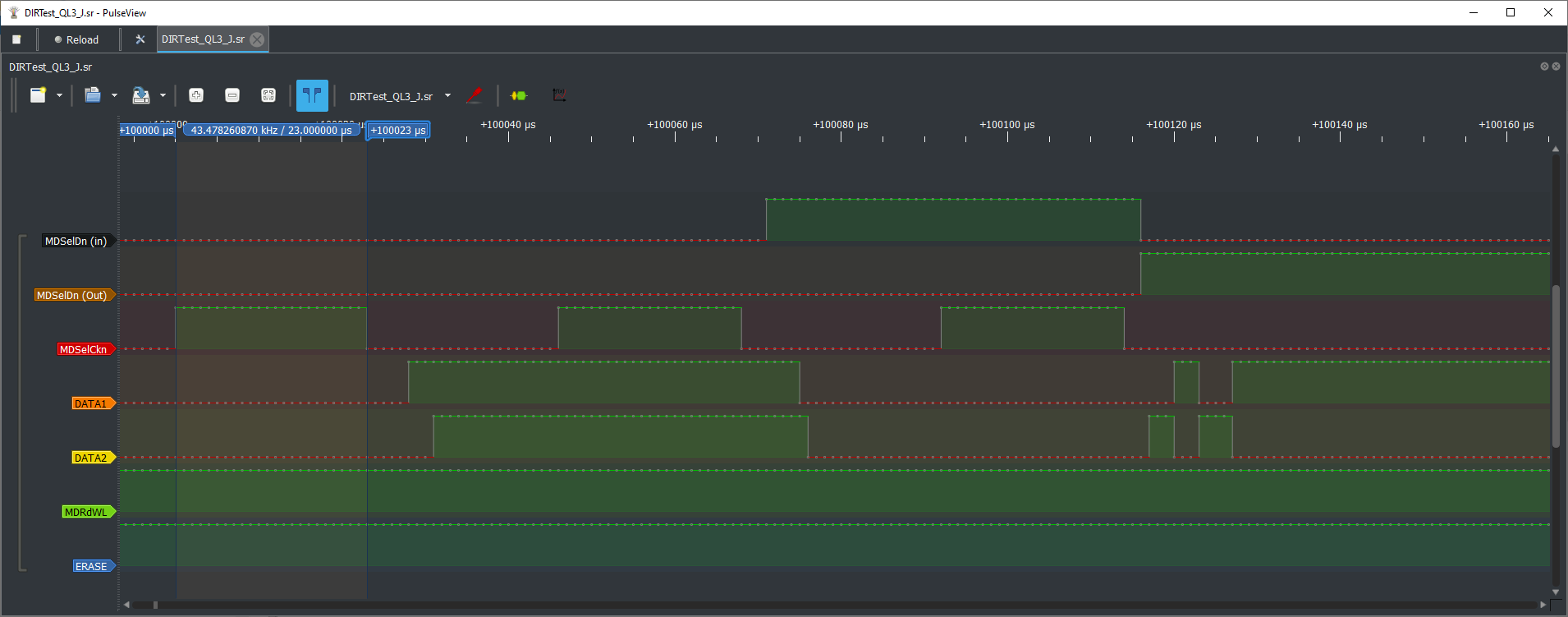

- Posts: 1131
Re: Recommended maintance & MDV ULA Problem
Hi Martin
For what its worth, attached here is an image from an old capture-trace I took of the MDV signal lines at the very start of a 'DIR mdv3_', as seen at the MDV-Extension port. MDV3 was a ZX unit, attached externally to the QL, as you'd imagine.
A few points:
a) I was wrong about the edge used in the MDV Clk signal - we see in the trace that the MDV ULA detects the MDSELN signal (aka COMMS-IN) on the falling Clk edge, not rising as I wrote previously.
b) You can see in the trace that the MDSELN (inbound) to MDV3 - which is actually the outbound MDSELN from MDV2 - is activated after the second Clk pulse - as it passes out of the 2nd MDV ULA. Only then following the 3rd falling Clk is it activated on MDV3's MDSELN outbound/COMMS-OUT - where it remains in-force as there are no further Clk pulses. It is MDSelDn (out) - as titled in the image - that drives the Motor/Erase (and WP) to MDV3 via it's own pair of PNP/NPN transistors.
c) The Clk pulse does indeed appear to be in the 25 us range (oops! I did say 25 ms before - meant 25 us!)
Good luck!
A few points:
Good luck!
