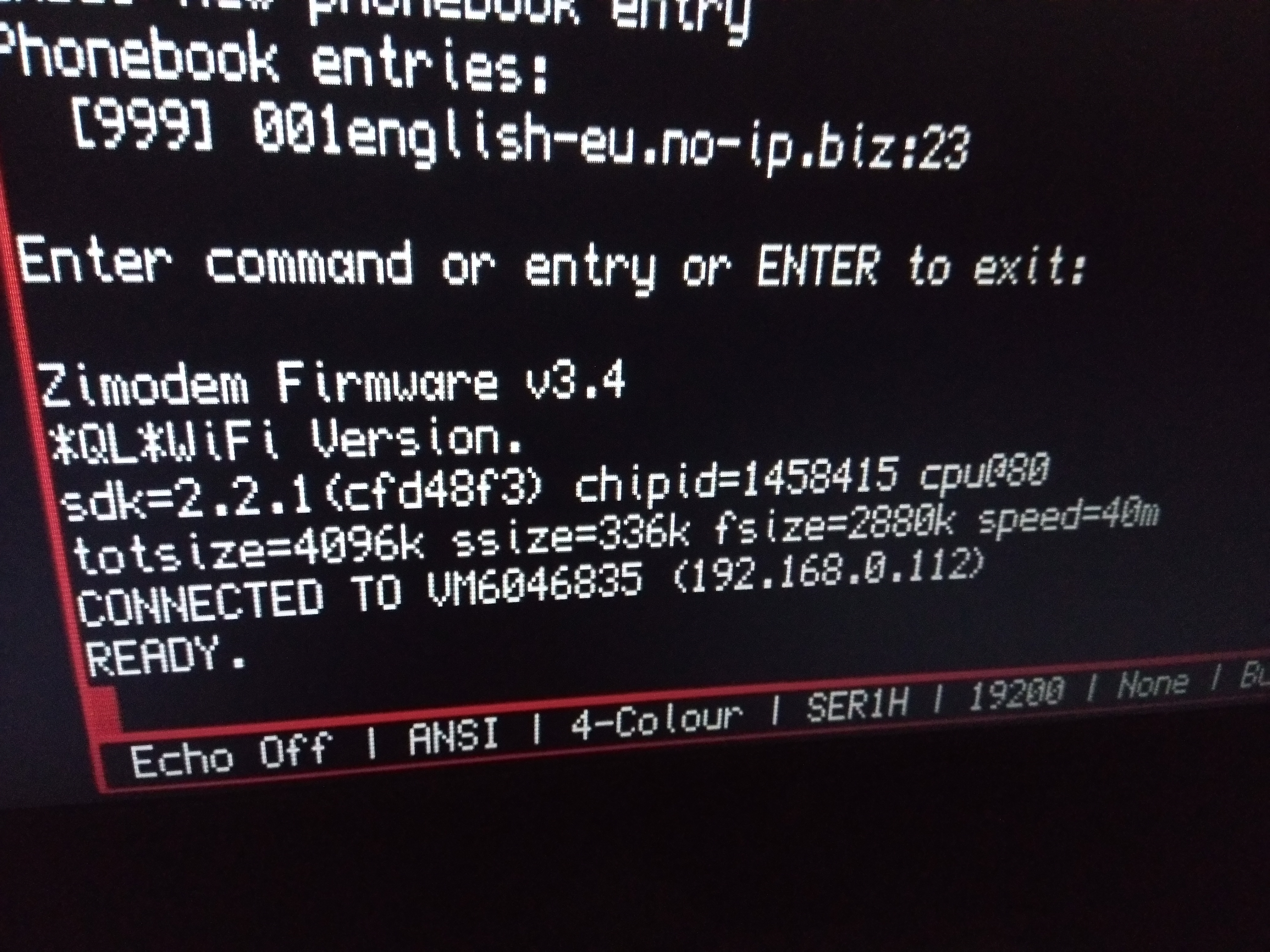

Derek,
I have made a few of those. I found the 3.5 firmware not to work. I use the 3.4 and it works great. Another pitfall was finding a genuine MAX232. I bought some MAX232 based converters from china (thankfully socketed) and the MAX232 was running hot. I also got some random characters after a while. no issues with some MAX232's I had in stock. If the converter has RX/TX LED's this comes in handy for a retro look. The 8266 boards are cheap from ali and work fine. The max232 converter I bought came with free dupont jumpers and effectively didn't even require soldering. Unfortunately finding a max232 converter with flow control was not as easy and certainly not as cheap (although to be honest maybe this was a bad option due to the crapola 232's). I added a couple of bodge wires to the socketed DIP max232(which to be honest was an easy option as it was DIP which gave a good anchor point) and used the unused I/O of the max 232 to the control lines on the 8266 and the 9pin D.
The *QL*wifi edition doesn't actually exist, it was just a bit of hex editing to remove the C64 banner
