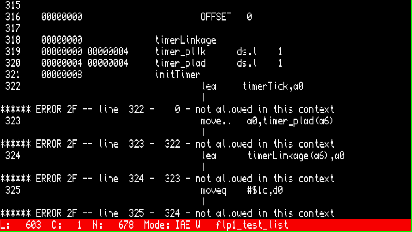

I can't get most of this to assemble especially anything referencing "(A6)" which throws "relocatable value not allowed here"tofro wrote: Thu Feb 22, 2024 1:07 pm I tend to use code like that:

You are declaring these variables within a SECTION, which produces relocatable values. You should declare them within an OFFSET section (e.g. OFFSET 0), which declares them as simple (scalar) values from the specified offset (normally starting at zero). Then reserve some space for it (normally in the job's dataspace but it can be in code space too) and let A6 point to it.t0nyt wrote: Thu Feb 22, 2024 3:11 pmI can't get most of this to assemble especially anything referencing "(A6)" which throws "relocatable value not allowed here"tofro wrote: Thu Feb 22, 2024 1:07 pm I tend to use code like that:

Thanks Jan, but I don't currently even understand what you mean by "Then reserve some space for it (normally in the job's dataspace but it can be in code space too) ". I'll have to read up on this as I don't see how the code in the OFFSET ends up in the reserved space in some way. And the last part of the code references stuff that isn't declared anywhere in the code so I'm totally lostjanbredenbeek wrote: Thu Feb 22, 2024 3:58 pmYou are declaring these variables within a SECTION, which produces relocatable values. You should declare them within an OFFSET section (e.g. OFFSET 0), which declares them as simple (scalar) values from the specified offset (normally starting at zero). Then reserve some space for it (normally in the job's dataspace but it can be in code space too) and let A6 point to it.t0nyt wrote: Thu Feb 22, 2024 3:11 pmI can't get most of this to assemble especially anything referencing "(A6)" which throws "relocatable value not allowed here"tofro wrote: Thu Feb 22, 2024 1:07 pm I tend to use code like that:

Well, QDOS programs normally tend to store their data in the data space (hence the name
). That is an area of memory normally after your program code which is allocated for you to work with. You tell the assembler (if you assemble with "-NOLINK") using the DATA directive how much you want (or it will allocate a default of 4k for you). When your program is started, a6+a4 points to the bottom of that space, so one of the first instructions in most of my programs is
and a6 is never touched again later on. You can then use a6 to point into that space to use it for variables. This is done so that multiple jobs executing the same program can share the code, but have separate data. Maybe not so relevant for a game, though.
lea.l 0(a6,a4.l),a6 ; let a6 point to data space

Thanks Tofro, so "OFFSET 0" puts the code at the start of the 4kb?tofro wrote: Thu Feb 22, 2024 5:00 pm Well, QDOS programs normally tend to store their data in the data space (hence the name). That is an area of memory normally after your program code which is allocated for you to work with. You tell the assembler (if you assemble with "-NOLINK") using the DATA directive how much you want (or it will allocate a default of 4k for you). When your program is started, a6+a4 points to the bottom of that space, so one of the first instructions in most of my programs is
and a6 is never touched again later on. You can then use a6 to point into that space to use it for variables. This is done so that multiple jobs executing the same program can share the code, but have separate data. Maybe not so relevant for a game, though.Code: Select all
It still won't assemble code after an OFFSET though (the offset section is at the end of my source file)
