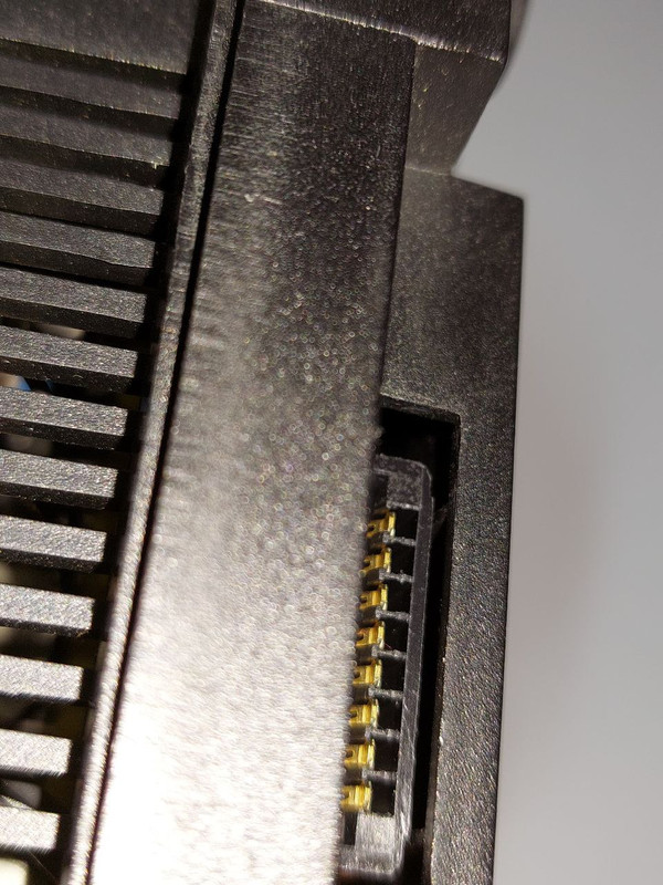

Last not the less, I detect an issue that it is about original version 1.0 and modified version 1.2 (at least I named it like that. PCBWay version is 1.0, GitHub version is 1.4).
The Edge socket get pushed down by the case rails (upper), so... no solution for it without mechanization of the Edge connector or removing rails (I don't like this one at all, because rails are there to lead the original MicroDrive cartridge).
See picture:
If you are going to do more than one board with it, and found same problems... please await some weeks till I get my own design of those boards and make them public. But my version (I call it 1.4) will not solve the EDGE connector issue (illustrated in last photo).
So... that is all with the main branch and modifications on it keeping retro compatibility. with previous versions
