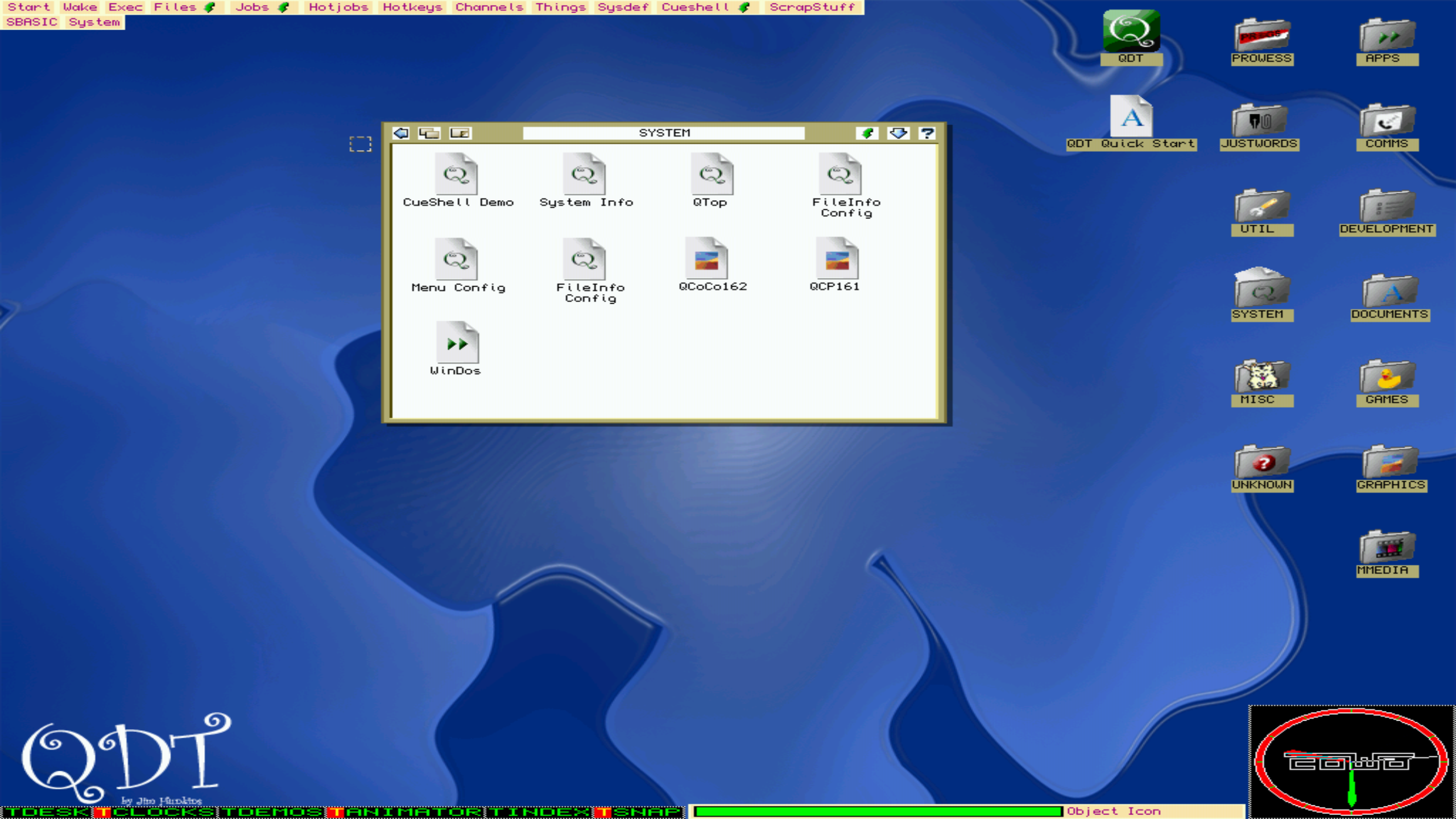

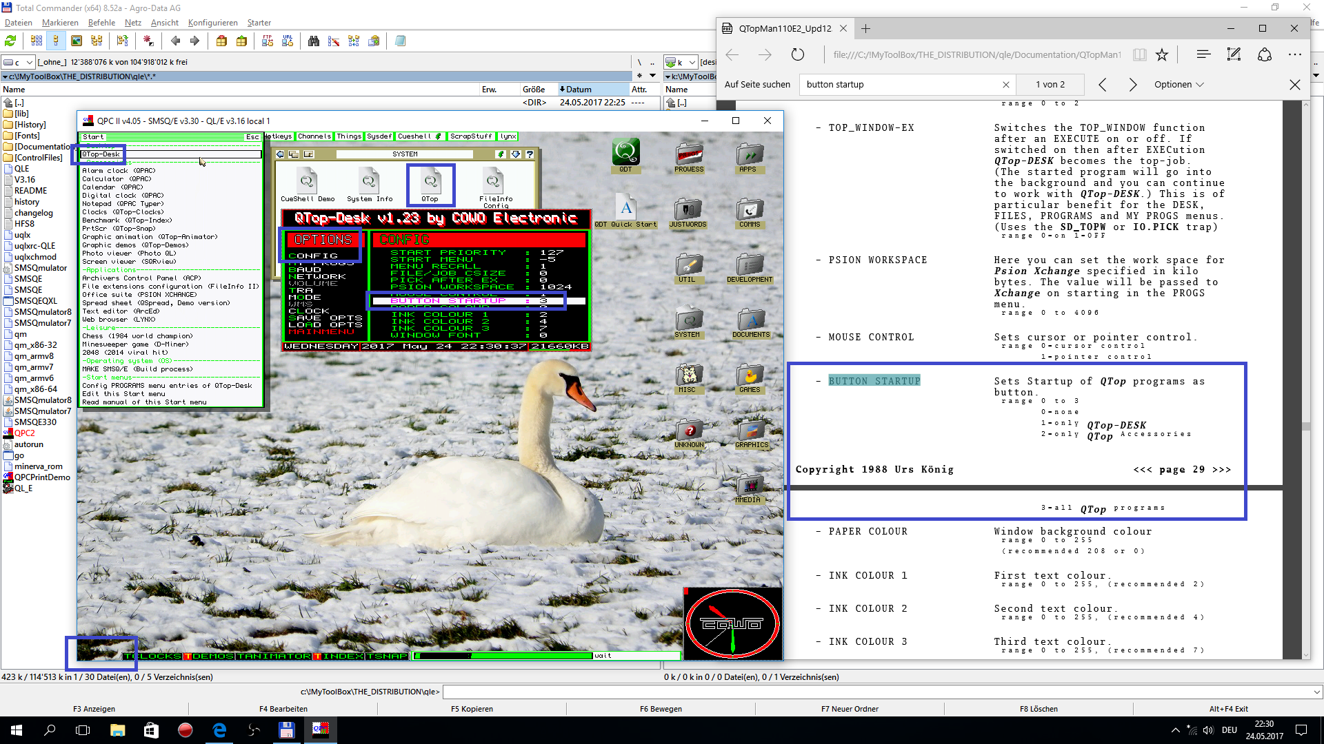

It does work, it starts a new instance of Qtop-Desk every time you invoke the QTOP icon.
Go to SBASIC and invoke JOBS. You’ll see a job named “Alt SysReq” (this is QTop-Desk) for each started instance of QTop-Desk.
But you may not get aware that a new instance was started because it starts QTop-Desk as a button named TDESK on bottom-left corner of the screen.
Do a "DO" on the TDESK button and QTop-Desk awakes.
There are ways to configure if and how the proggrams of the QTop suite appear at their startup. Use the CONFIG feature of the OPTIONS menu. See QTop manual. And don't forget to SAVE the OPTionS.
