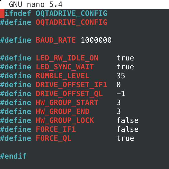

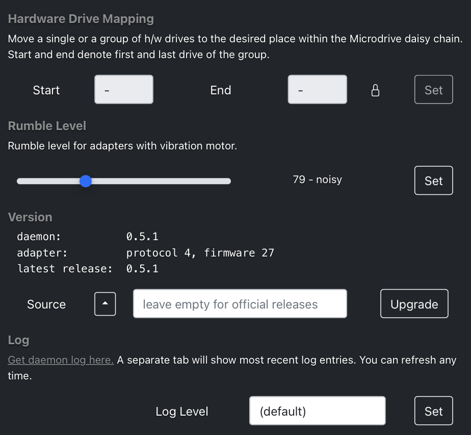

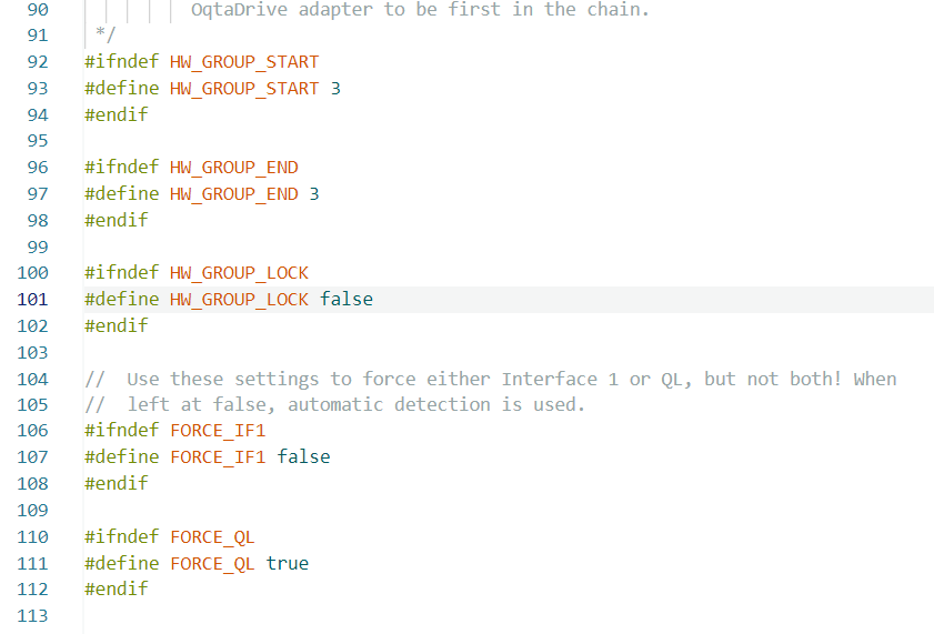

Now that I have got a non resetting URL back, I am still having problems assigning a physical Microdrive to my system. I have changed the Arduino config and even SSL’d into the Pi and updated the config.h file (as shown in the attached), but I still can’t get the URL to allow me to set the hardware drive mapping as it is always locked.Pepperm wrote: Sun Jul 02, 2023 9:06 pm Hi
Additionally, how do I access the real hardware, microdrive 2? The mapping function on the config page doesnt seem to make any sense to me and any attempts at remapping the drive just doesnt work. There is mention of a link being made on the PCB in the instructions but I cant find this link and as there isn't a proper schematic I cant figure out what the issue might be.
Mark
Any help would really be appreciated.
