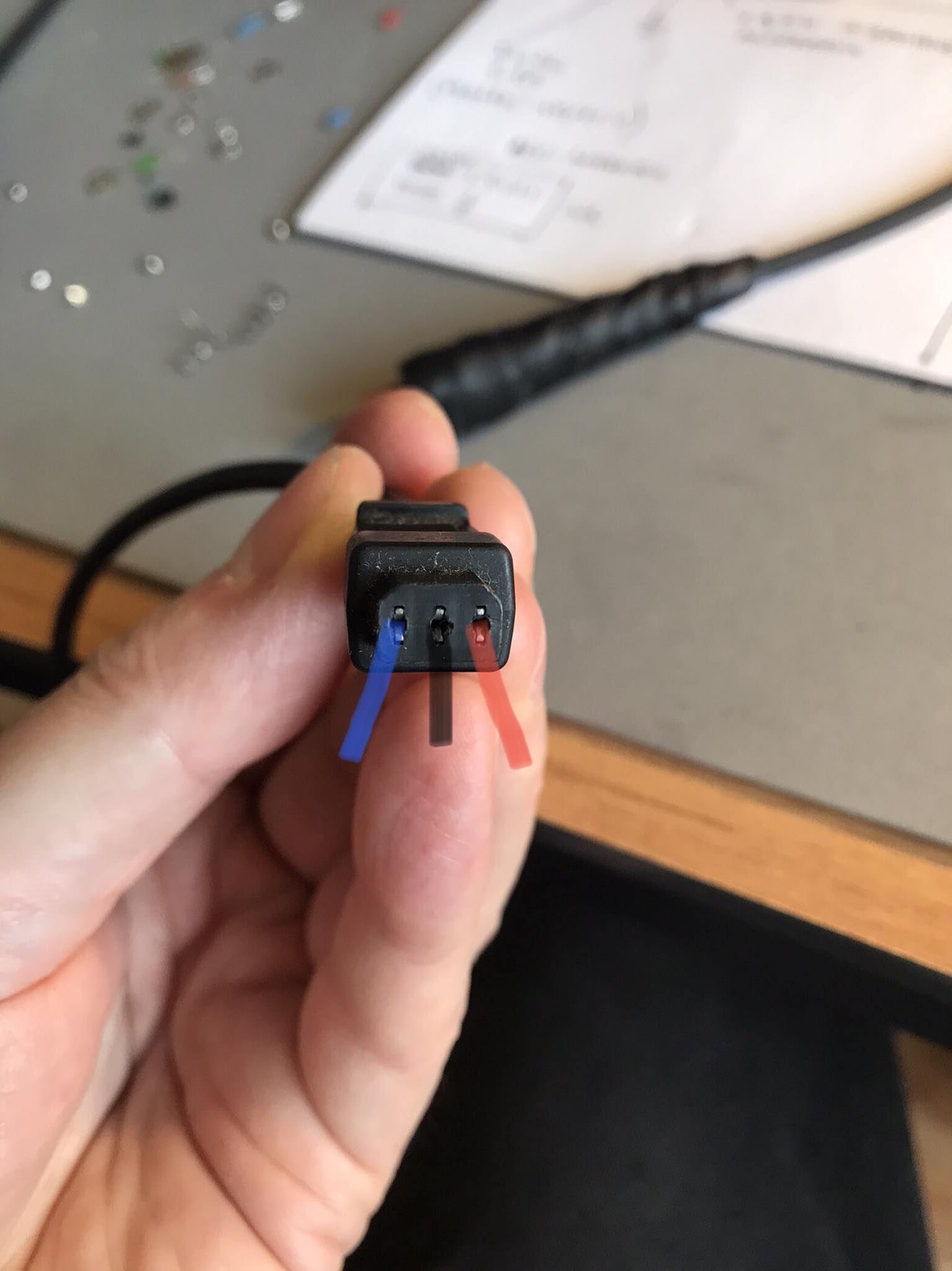

Hi again guys, I just introduced myself in the Wellcome section. As I said I'm a new user of a Sinclair QL, I'm waiting for a new keyboard membrane from sellmyretro which will arrive in days. Meanwhile a neighbor of mine gave a homemade PSU. Connecting it to my QL I see the menu screen correctly, both using an RGB cable and using the antenna one. Out of curiosity I went to check the output voltages from the plug: on the blue I have 18.5 V alternating current and on the red 7.6 V direct current.
I read around on the internet that direct current should oscillate between 10v and 12v while alternating current should be 15.6v.
Can I use this PSU? Or do I risk doing damage?

When I was fixing my PSU these correct values were quoted.Robbizz wrote: Mon Jun 05, 2023 6:19 amoutput voltages from the plug: on the blue I have 18.5 V alternating current and on the red 7.6 V direct current.
Did you put a load across the pins when taking a measurement? The 7.5V means you will waste less heat on the 5V regulator if it works. The 18.5V is a bit high so damage might occur eventually due to continuous over stressing components. My no load measures Red 11V DC & Blue 16.6V ACChr$ wrote: Wed Dec 25, 2019 9:15 pm Around 16v AC sounds about right for one of the required voltages. There should be about 16v AC and 9v DC and on the plug the middle pin is GND.

This afternoon I will do some measurements with the computer turned on, in this way I can actually understand what the voltages are. Thank youRuptor wrote: Mon Jun 05, 2023 10:27 am Did you put a load across the pins when taking a measurement? The 7.5V means you will waste less heat on the 5V regulator if it works. The 18.5V is a bit high so damage might occur eventually due to continuous over stressing components. My no load measures Red 11V DC & Blue 16.6V AC

Actually the guy who sold me the transformer already has two QLs both powered by the same transformers. He reassured me that he built these transformers based on his own experience. I was just wondering (that's why I wrote here) what other users of these voltages think. I just now measured the voltage when the QL is powered and turned on: I get 7V on the DC section and 14.6v on the AC. I have not used any bulbs or other loads with these measurements, I simply measured from the inside with a tester. Incidentally, the guy who gave me the transformer told me that it can be used for hours without the internal heat sink getting hot.bwinkel67 wrote: Mon Jun 05, 2023 11:23 am Maybe use a light bulb or something to put a load on the power supply. I'd avoid trying the QL because if the power is indeed too high, you'll damage something.

7V on the DC end might in fact be a little tight (7V is the minimum the 7805 needs to create the internal 5V). But that's rather the "might not work under heavy loads, but won't break anything" end. The AC end seems fine to me.
