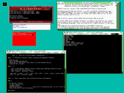

As you can see from my image I get the Qlib error "Ambiguous name" when I try to compile your sample code. I updated
my QPC2 environment to be the same as yours.
If WHEN ERRor works on your setup I must be doing something wrong.

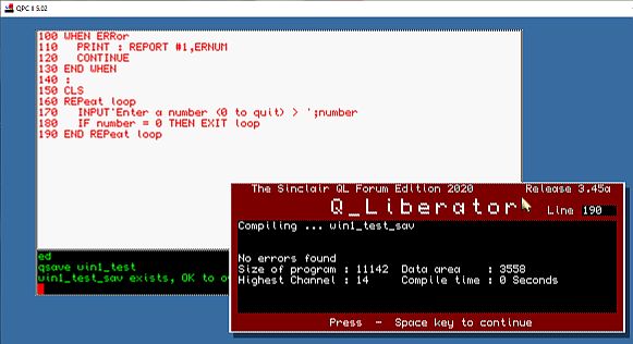

I've had a quick look as it's quiet here and have attached a couple of files for you to try. My main worry is the rather flaky internet connection here (hotel wifi poor, so am tethering phone to laptop to try).
I've cut the WHEN ERRor example down to minimum, just trapping a numeric INPUT statement, to see if it'll compile. It did. So the zip attached has the _sav and _obj files for you to see if you can EXEC my compiled example (test_obj) and compile from my test_sav file. As you can see from the screen dump, it compiles OK on my system (QPC2 v5.02 and QLiberator 3.45a)
This is the test program - test_sav (or it might zip as test.sav) in the zip attached.
100 WHEN ERRor
110 PRINT : REPORT #1,ERNUM
120 CONTINUE
130 END WHEN
140 :
150 CLS
160 REPeat loop
170 INPUT'Enter a number (0 to quit) > ';number
180 IF number = 0 THEN EXIT loop
190 END REPeat loop
