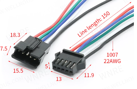

I have been looking at JST SH connectors, which are 2.0 mm pitch, something like this, with 4 pins: But the panel mounted connector extends too far out to the Q68 Back Plate, so I will need a spacer to move the connector back into the case.

I am am having a some problems with the fitting the I2C connector on the Rear Panel.
I opted for a JST-SH male socket connector, which is shown is a message above, the problem is finding a panel mounted connector.
I might review the necessity of fitting the I2C connector, is this wanted?
